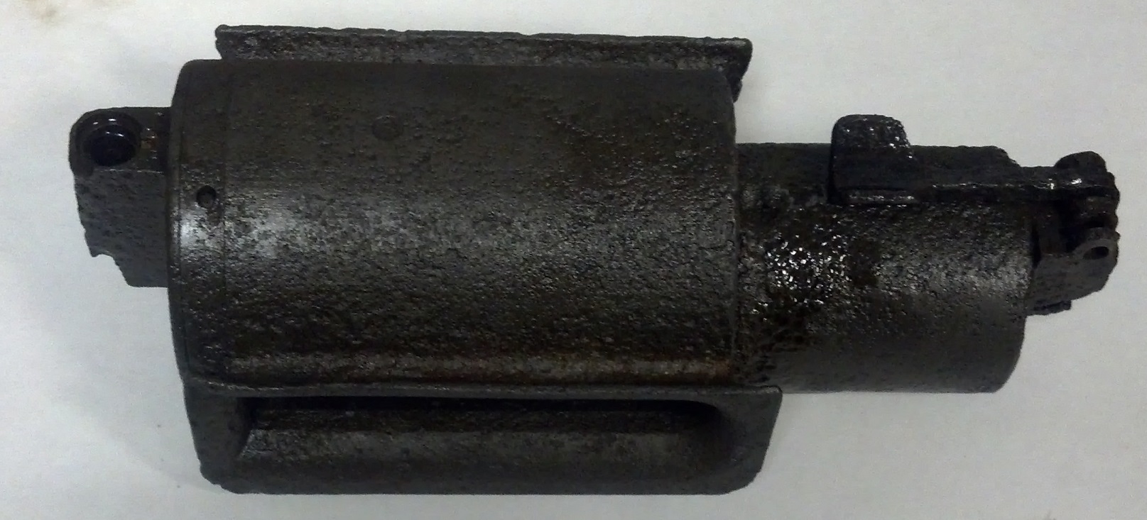

... another said there was a cam device fitted to the prop shaft that created an interruption based on RPM...
I assume that this "cam device" is actually a reference to the oscillating block mechanism:
