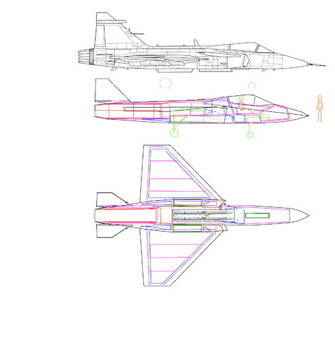

Here's one rough idea how it could be done. Just for fun, mostly.
I'm talking about a plane in the JF-17/Gripen A/C class, as per the opening post. That's between 6600 and 6800 kg. So 6700 kg limit it is.
The issues with the above sketch are numerous. Since i tried hard to stay within the 6700 kg empty figure, I had to make the plane shorter than Gripen, with shorter intakes. Shaving off structure wherever possible. Because the weapon bays and landing gear took up valuable room and made the plane chunkier than Gripen is.
Even so, anything more than weapon bay for 2 amraams seems impossible. (amraams here aren't the best drawn, if they were rotated correctly two of them should fit)
But the biggest issue is fuel. F-16 for example has some 1070 gallons of internal fuel. (gripen has 750 gallons internally) This plane is likely not going to fit more than 500, 600 gallons at most. That's going to translate into quite poor range. Not helped by the fact the plane would be chunky.
Short simple intakes and drag are probably going to make it quite slow. At best as fast as F-35.
Shaving off more weight, I went with a butterfly tail. Which while good for stealth is not so good for maneuverability. Perhaps all moving tails might help there a bit, though in the end it might be that 3d vectoring engine is going to be needed to rectify the lack of pitch authority.
Is 2 amraam class missiles going to be enough? Probably not in today's world. And lack of range would simply stop this kind of design from being made. Gripan can do 3000 km ferry range with internal and external fuel of 1650 gallons. This plane would have a little more than a third of that range. (Perhaps 1200-ish km?) So range would be abysmal, comparable with MiG-21 on internal fuel only. Now, since the whole point of the project is to have a very stealthy plane, then external tanks are probably off limits for combat missions. Same thing can be said for adding weapons externally.
It just shows how clogged the design is, when trying to fit everything into such a small package.
What would probably happen then is what always happens when requirements are trying to be met. Plane would get bigger, longer, heavier etc. So to get any sort of usable ferry range (2500 km?) with, say, 3 AAMs we'd probably be looking at something closer to F-35 in weight class than to Gripen.
I guess plane could be made a bit lighter (or made a bit bigger for the same weight) if airframe was made to last only a short time. Or if wings weren't designed to carry any heavy loads. But would that be worth it? Having a still expensive stealthy plane that can do only 3000 flight hours and can never carry external ordnance heavier than 500 kg under wings? All for a few hundred kg lighter airframe?
So it's obvious why we're unlikely to see stealthy planes in tiny, gripen-sized packages.

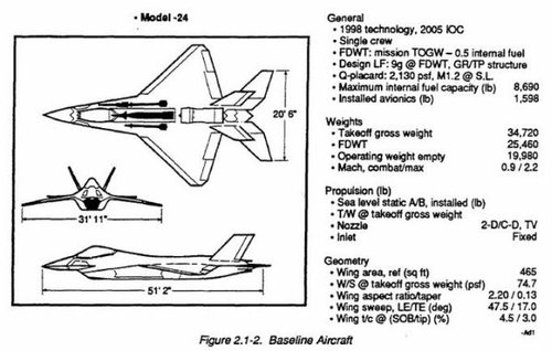

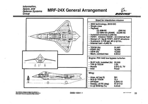

Boeing seemed to have studied a lightweight stealth fighter on at least one occasion. There was also a tailless design that seems to be related. On either I'd expect some weight growth from the paper version to an operational aircraft. However both only seem to have AIM-9X for self-defense (no AIM-120) so that seems like a bit of a limitation. To perform the air-to-air mission these days you need medium-range missile capability.

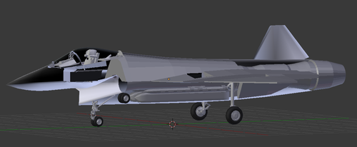

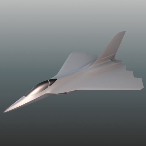

I didn't knew those, but a small "mental exercise" from mine resulted in something relatively similar to the first example, at least in regards of the internal layout. My idea was a bit bigger than a Gripen, rather inspired by the F-16 since I think internal bays with a modicum of A2G ordnance capacity and a strict light fighter design are not really compatible. 9-10 tons empty weight look the minimum, considering the sizes of today's weapons at least. Not a real problem IMO, since they could be served with one heavy-fighter sized engine.

wow some awesome pics! lookalike the MDD JAST had one normal sized bay and 2 AAM sized ones

Model 24: 9,400

These are very nice finds!
And they're quite fascinating, even hard to believe. The above design is basically just a bit bigger than F-16 block 50, weight wise. (8600 kg vs 9000 kg)
But Boeing managed, at least on paper, to cram in two side weapon bays for sidewinders and a central weapon bay measuring 447 by 89 cm. Even assuming some of that bay length is tapered, shallow ends, it's still enough for at least two amraams. Or two 2000 lb class bombs. So basically, they've got close to F-35 requirement, with two large bombs. Only changing the 2 additional amraam requirement into 2 sidewinders requirement. And probably the central bay can't feature more than 3 amraams (3 would have to be staggered as in F-22) whereas F-35 can possibly cram in a total of 6. So that's 6 versus 3+2 short ranged missiles.
But still quite respectable, considering the weight is just 9000 kg! Compare that to F-35A's 13300 kg.
Then there's internal fuel. F-35A carries 8300 kg of fuel, while this design proposal cites only 3945 kg. Granted, F-35 is almost 50% heavier so that amount of fuel would likely be enough for 70% or so of F-35's range. (hard to tell how draggy this design is, and range is also function of payload) Which... is actually still poor. 2000+ km ferry range is nowadays not nearly enough.
Anyway, tradeoffs are quite evident, so the whole design is still somewhat understandable.
But the lower design is just wow. That's a 12.9 m long plane with 8.3 m wingspan. And empty weight of just 5700 kg! That's a whole ton less than a Gripen. Basically the lightest, smallest combat plane the West made since F-5 or something like that. And yet... And yet it carries 2933 kg of fuel internally. Ferry range it should be even better than the above plane, being that light. It might even be closer to F-35 ferry range. Of course, when carrying bombs, combat radii will probably start degrading heavily compared to larger designs like F-35.
Still... Boeing managed to cram in a bomb bay measuring some 3-ish m by 1 meter and two side weapon bays for 1 sidewinder each. It's unclear to me if the main bomb bay can actually go to 3.7 meters required for amraam, but i'd say it can't, looking at the room needed for the intake.
So the whole plane is more of a bomb truck. Which the document actually says, mentioning "sized for interdiction mission". That could explain why no tail surfaces either. The design is more of a striker than a fighter, not requiring serious maneuverability. But still... 5700 kg empty weight for all that range and decently sized weapon bays???
I'd say those designs are actually rather far from what could be achieved. Because if they were possible, then Boeing could have scaled those up to X-32 weight class and could have blown the X-35 out of the water. Which it did not.
Curiously enough, the overall layout of these two designs is still quite similar to what Boeing proposed with their X-32. Intake is a bit different, the wing is a bit different and the end of the plane is unique to each variant. but the same philosophy can be observed. And even the tail differences aren't that drastic. Boeing was unsure what to go with, depending on requirements, when it comes to tail for X-32. More of a fighter required a full tail. Semi striker-fighter was possible with a butterfly tail. And evidently they thought they could get away without a tail for a pure strike plane.
Also - what's up with those short engines? Above design has a 3 m long engine drawn in, and the below design features an engine just 2.6 m long. Apparently lacking afterburner, which is curious since top speed of both is above mach 2. And it looks to me that the afterburner could not even fit in the design below as it is drawn.
Are you consulting for Sukhoi? ;)
