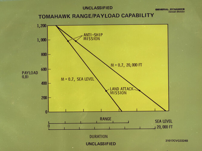

Kinda interesting that the range of tomahawk in high altitude cruising is only twice that of low altitude cruising. It could be because Tomahawk is ground launched so it need to climb (which consume more fuel) if it want to cruise at high altitude?
