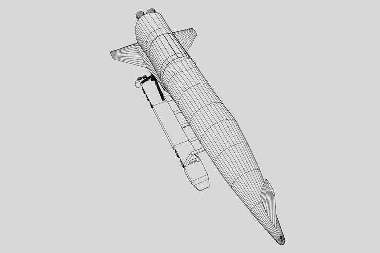

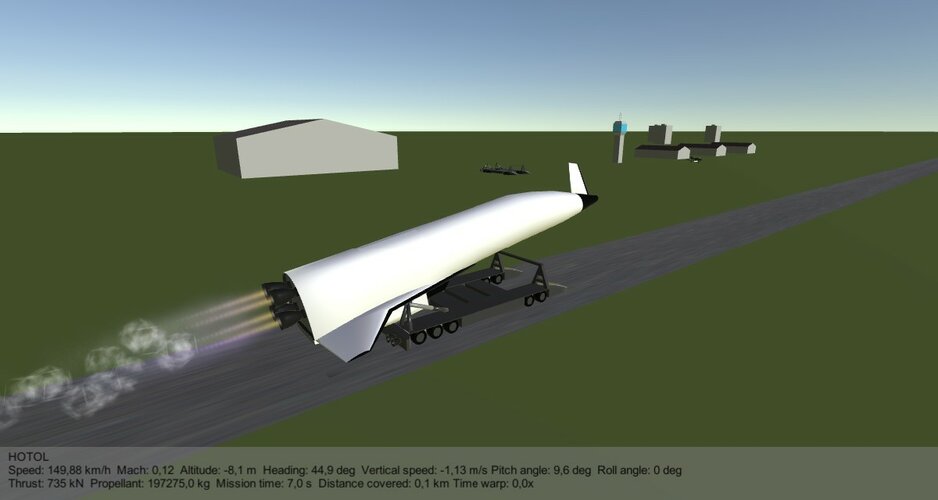

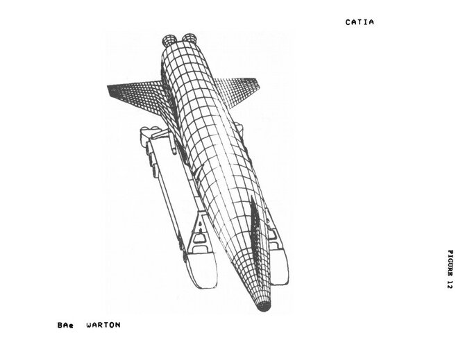

Eagerly looking forward to this book! Though on the other hand a bit terrified on how much I'll have to rework my HOTOL model (which tries to represent a circa 1987 configuration) if we get more accurate diagrams :D
Hotol's major configurations each had a letter in alphabetical order. This one is Configuration F, which was first devised in mid-March 1986 and officially became the new baseline design at the beginning of July 1986. A new variant, Configuration G, became the next baseline design at the end of June 1987.
Why have the hassle of all that editing when you can just make a new one from scratch and then you won't forget which parts you've edited and which you haven't?
Well, I used "rework" as a generic term ranging from minor adjustments to a completely new model.
Thanks! I knew about the alphabetical designations but not which one this was. Looks like 'K' may have been the final HOTOL iteration?
Interestingly Skylon seems to have adopted a similar system with additional suffix numbers (eg. C2, D1, LAPCAT A2...)

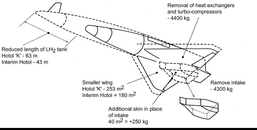

Yes - Configuration K was the last of the airbreathing line. I have a 1992 drawing somewhere of Interim Hotol with 'Hotol M' in the description box, but that designation doesn't seem to have stuck.
The nine main iterations were: A, B, C, D, F, G, H, J and K. There was no 'E' and no 'I'. And within those nine, there were further subdivisions - G3 for example. Many of the design proposals and changes didn't get a specific designation.
Interim HOTOL work with Roc from Stratolaunch?
In the drawing above, the air breathing part was pictured "detached" to show how omitting air breathing reduces length.
But an actual detaching block parachuting down--that ever looked at?
(Simpler than spacejet...just a ramjet for this use unlike full sized HOTOL's engine.)
Brief investigations were made into retractable, shielded and jettisonable intake pods - yes (during August 1986). But according to Hotol project manager Sandy Burns, "these alternatives appear to involve more penalties than benefits".

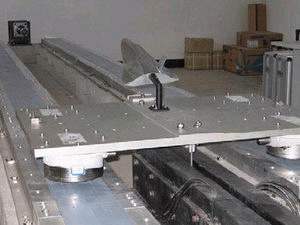

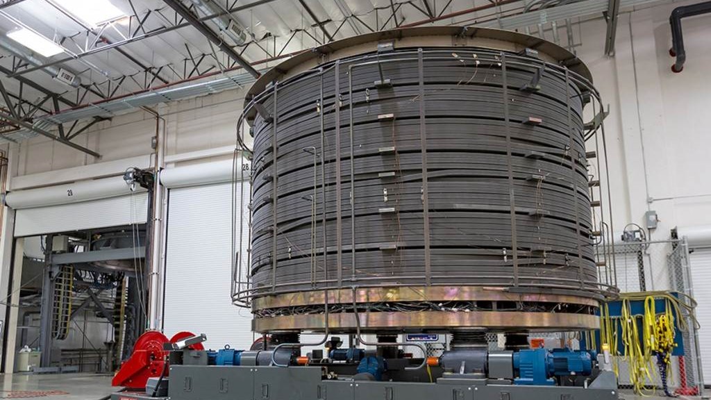

Magnets have gotten better:
With SpaceLiner using deep cryogens might a sled allow for a HTOHL approach easier on ground crew and passengers?
SS/SH may be a pain in the neck, literally.
While kerosene makes more sense as a first stage fuel, I think ease of handling should come first.
A very cold hydrolox filled first stage gives a maglev something to bite into, field effect wise.
A kerolox (maybe tri-propellant?) winged upper stage might have simple jets so that—after re-entry—it’s just another jet plane.
I have this image in my head of a forklift driving up to the back engine compartment and sliding out the engine block in one piece and sliding a new one in…such that refurbishment takes place indoors…maybe in a pit…like operating theatres of old. Here, you look down…almost a giant glovebox, but with waldos manipulating things. The big booster pumps propellant into the upper stage and it can return as a drone…dead-stick.
While Musk is interested in typical rocketry—perhaps a better approach would be “how would an MRO worker design a spaceplane?”
If I were a plumber, I would have a kitchen a half-floor above an exterior service corridor—there, all pipes are at head level…
That kind of thing. A Mike Rowe approach.
Did I miss it?
None of the references claim improvement to magnetic flux density.
Two related to levitation, one of which must reduce the flux density (although they neglect to say it…. “2/10 must try harder)” and two more wildly impractical LH2 superconducting schemes….. don’t they have any idea of H2 liquidfaction energy demand, leakage, GWP multiple, flammability? …. Sorry just mentioned the unmentionable.
This looks pretty stout;
Don’t know about this:
I do seem to remember permanent magnet advancements…

1 - A pinnacle of human achievement He supercooled electro magnet - yes wow, but the cost to build/operate? Have you seen the supporting ITER supercooling plant required to supply it with LHe?
2 - a five year old patent for magnetic invention that would change the world, only it hasn’t. You do know patents require no validation proof, …..patents have been granted for time machines.
3 - a magnetic gearbox - My very own fingers spun one of those about 15 years ago (Magnamatics Ltd), magnetic gears might have been around prior to this….a very expensive solution looking for a problem to solve that’s easy to solve by cheaper alternatives.
The key metric for the performance potential for practical magnetic application is flux density and that hasn’t improved for 25 years.
I’m not sure how any of this gets you to a low cost launching system.
