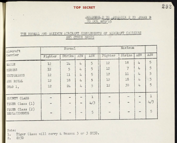

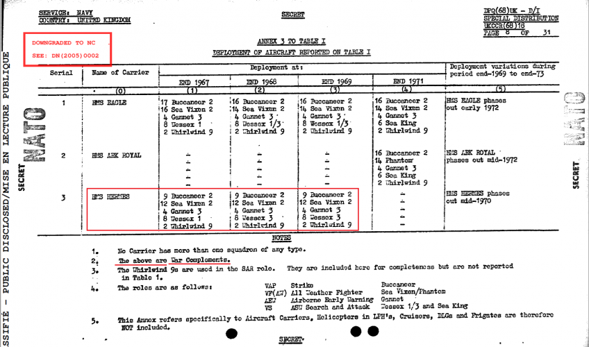

What was the maximum number of Buccaneer S2s ever carried by HMS Hermes?
Tom Eeles's book 'Flying in Father's Slipstream' says HMS Hermes had 6 Buccaneers in the summer of 1968, and on August 23 the RN sent 4 Buccaneers from Scotland to HMS Hermes in the Malacca Straits to demonstrate a rapid reinforcement of the Far East Fleet, with the First Sea Lord in the back seat of one of the four Buccaneers.
So the maximum number of Buccaneers ever carried by HMS Hermes was 6 + 4 = 10?

Here is what I have from a now-defunct Fleet Air Arm site (not government-related):
Carrier Air Group
Years ............. Squadron ... Aircraft ...................... Total
1960-1962 - 803 sqn. - 8 Scimitar F1 ------------- 30
...................... - 890 sqn. - 12 Sea Vixen FAW1
...................... - 849 sqn. C flt. - 4 Gannet AEW3
...................... - 814 sqn. - 5 Whirlwind HAS7
...................... - Ships Flight - 1 Dragonfly HR5
1962-1964 - 803 sqn. - 8 Scimitar F1 ------------ 30
...................... - 892 sqn. - 12 Sea Vixen FAW1
...................... - 849 sqn. B flt. - 4 Gannet AEW3
...................... - 814 sqn. - 5 Wessex HAS1
...................... - Ships Flight - 1 Whirlwind HAR5
1966-1967 - 809 sqn. - 7 Buccaneer S2 ------------ 30
...................... - 892 sqn. - 12 Sea Vixen FAW2
...................... - 849 sqn. B flt. - 4 Gannet AEW3, 1 Gannet COD4
...................... - 826 sqn. - 5 Wessex HAS3
...................... - Ships Flight - 1 Wessex HAS1 (SAR)
1968-1970 - 801 sqn. - 7 Buccaneer S2 ------------ 30
...................... - 893 sqn. - 12 Sea Vixen FAW2
...................... - 849 sqn. A flt. - 4 Gannet AEW3, 1 Gannet COD4
...................... - 814 sqn. - 5 Wessex HAS3
1973-1979 - 845 sqn. - 9 Wessex HU5 ------------ 18
...................... - 814 sqn. - 9 Sea King HAS1
1981 - 800 sqn. - 8 Sea Harrier FRS1 ------------- 17
...................... - 826 sqn. - 9 Sea King HAS5
1982 - 800 & 899 sqn. - 16 Sea Harrier FRS1 ------ 34
...................... - 826 & 846 sqn. - 18 Sea King HAS5
