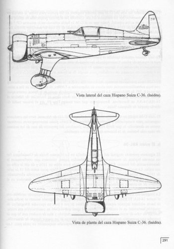

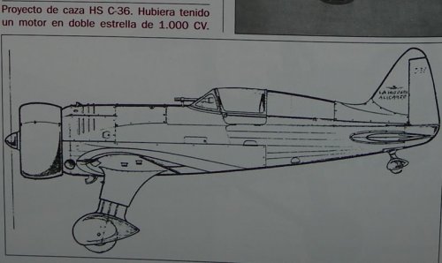

In 1934 Enrique Corbella designed a fighter the Hispano Suiza C-36, it should be powered by a HS 14-HA radial engine of 1120 hp.
Its possible that the design was based on the lines of the Fokker D.21.
What I read is that the construction was the same as used on the Fokker.
Enclosed some technical details and a side view.
Who knows/has more abot this project?
Maybe better drawings etc.??
