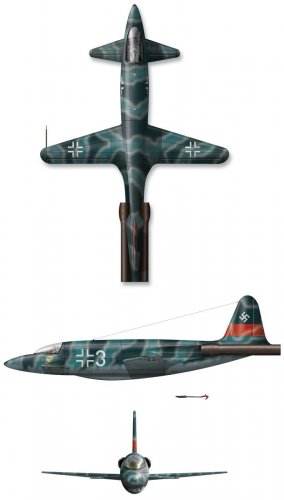

Hi
I remember reading somewhere the Hs PJ600 was designed for both land and ship launch.
Can anyone enlarge on this please?
In the meantime I've started a marine camo scheme...please ignore the hook ::)
Many thanks
P :)

Re: Henschel PJ600
It's mentioned by Novarra as "P.600", but with very few info. I once read about plans to launch fighters
like the Bachem Natter from small ships, either at the coast or from inland waters in order to make them
more mobile and for the ability to concentrate them. Maybe that's the kind of ship borne use, which was
intended for the P.600, too ? Don't know if there really were such projects, but at the end of the war, I
cannot think, that there were still considerations of true carrier aircraft, as the German Navy was limited then to
UBoats and ships not larger then destroyers due to the "Führerbefehl" (Fuehrer's order) from 1943.
Pulse-jet powered as the P.600 would have been, launching it via catapult from a ship would of course have
been possible, but I think the hook really would have been useless. ;)

Thanks Jens....thats why I asked for the hook to be ignored... ;) .
I took the PJ600/67 title from Igor's site, or part of it.
In Manfred Griehl's Volume 1, Jet planes of the Third Reich- The Secret Projects its named as the P 87 Canard which I think is in error.
I did read that most data/info was captured by Russian forces.
P :D

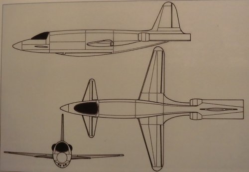

Perhaps good news, bought Manfred Griehls book "Henschel Flugzeuge seit 1933" (Henschel Aircraft since 1933)
today, and this aircraft is there mentioned, too, as P.136. This designation at least sounds more plausible to me,
than "PJ 600", so I arbitrarily included it in the title.

Hi Jens,
which other Henschel projects does that book include?
The P 54, P 87, P 122, P 135 and P 136. Maybe interesting, too, are photos of the windtunnel models
of the Hs 130C-0 and C-1 and of the HS 132.
