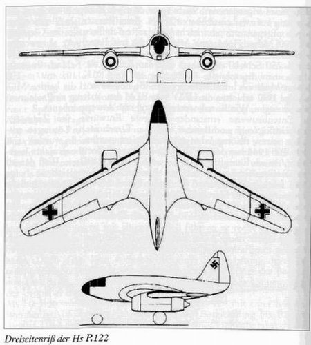

Certainly no need to post here, what can be found in Luft'46. Of the
Henschel Hs P.122 I found another drawing in Horst Materna "Die Geschichte
der Henschel Flugzeugwerke in Schöbefeld bei Berlin 1933 - 1945", which shows
a somewhat different cockpit glazing.

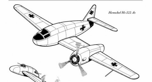

I've only got this one drawing (improperly designated "Hs 122"), which you probably know already:

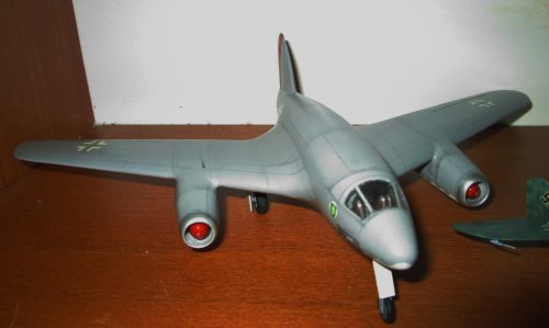

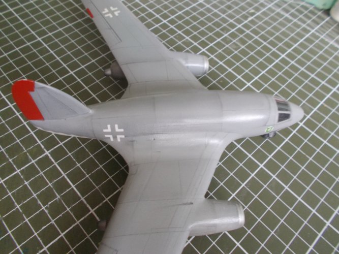

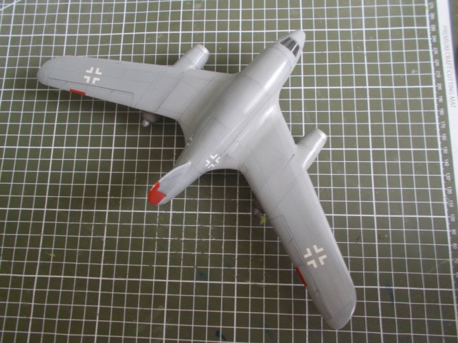

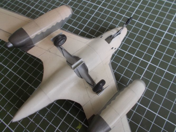

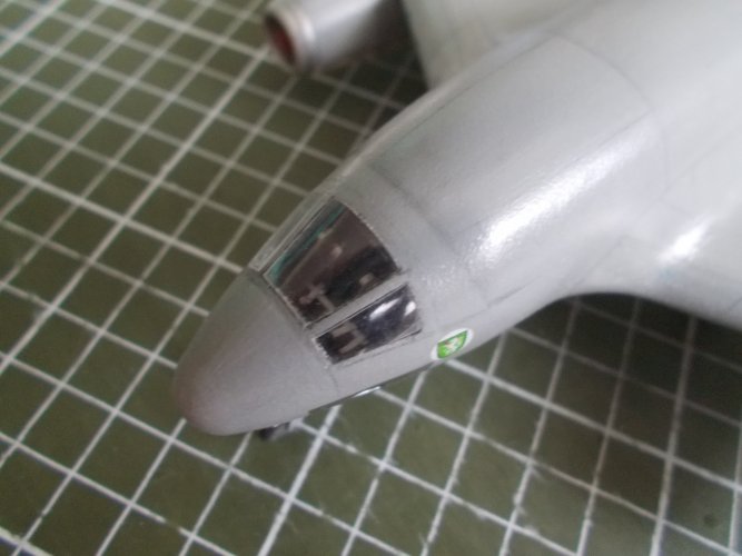

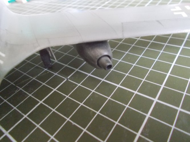

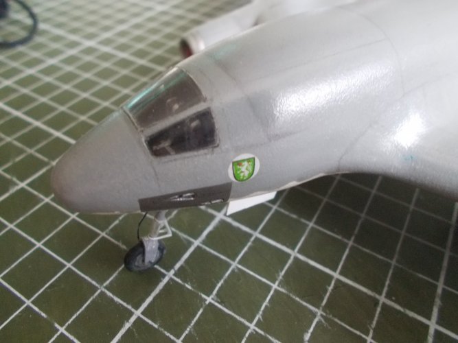

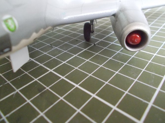

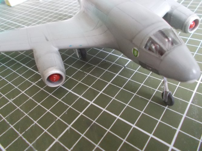

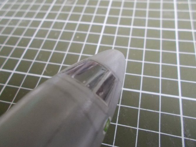

Model from Marat Nazmeev (photo Vladimir (Loki)
1:72 scratchbuilt
Thanks for the feedback!
It was very tricky to make any sense of the drawing and I may well have been chasing a red herring, but it appeared there were multiple small apertures around the cockpit area, rather than large glazed areas, as often portrayed in post-war drawings such as the one at the top of this thread. This does make sense, as the P 122 was supposed to be pressured and able to operate at extreme altitude. The only things that came close in WW2 Germany were the Hs 130 and DFS 228. Neither has large glazed areas. This reminded me of today's White Knight One and Space Ship One. So I went for that bug eye cockpit glazing style, tracing any lines I could discover in the drawing.
Marat's model is very nice indeed and this cockpit arrangement might have been possible too. Perhaps with extra bracing, like on the Bell X-1. A layout similar to the B-29 is also a possibility, but I doubt the Ar 234 C style we normally see on drawings would be feasible at 40,000 ft.
About the landing gear and bomb bay... In the original drawing there seem to be traces of a bomb bay in front of and behind where the landing gear would be. But it's possible the entire bomb load was to be carried on the wings instead - no doubt some sort of smart bomb, as Henschel was a pioneer in the research on these as well as high-altitude flight. The P 122 was no doubt to combine the results of both.
