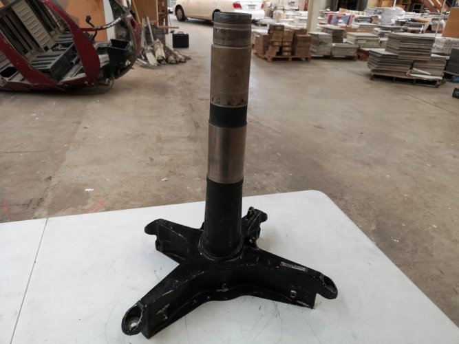

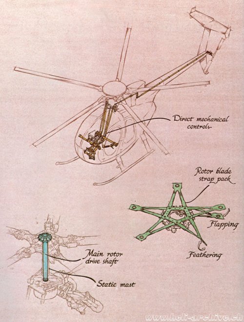

In all the design for rotor heads the best was MD 369 and the Apache, they both had a static mast that was contacted to the frame and not directly to the gearbox.
In the case of these airframes the static mast was hollow, and a torque tube went up inside. the rotorhead was locked to the mast and could rotate.
if the transmission failed the torque would strip and rotor would still be able to rotate for auto rotation.
The swashplate moves up/down the O.D. of the static mast.
None of the head loads and the like would ever be transmitted through the MGB.

I then added my thoughts on the best design rotorhead in my opinion, the Hughes 369 and Apache due to their static masts.
Which is completely irrelevant to a crash involving a Bell 206, which has a Huey-type two-bladed teetering rotor.

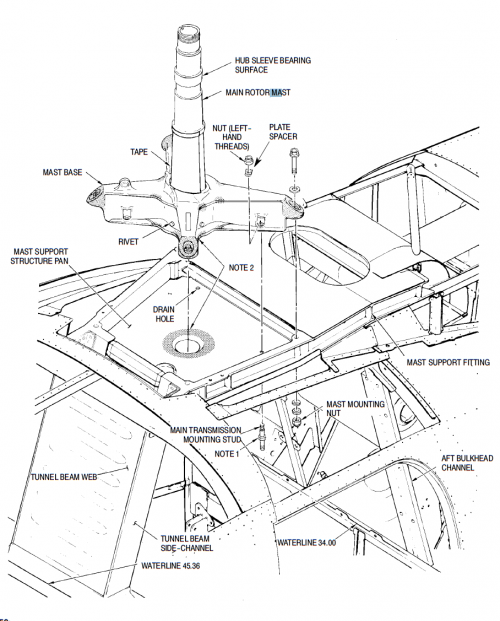

This is definitely going to be an Emergency AD crash. Probably have to start eddy current inspecting the frame and fuselage pieces holding the rotor gearbox to the airframe.

The Jesus nut was loose.
That is not consistent with the way the helo came apart.
Look at the picture, the whole damn transmission and rotor mast came out on the bulkhead it bolts to, IN ONE PIECE.
If the Jesus nut came off, the rotor head would have come off the mast.

The Apache uses strap packs, just like the old 369 which allows for lead/lag, flapping and feathering. Also gets rid of the bearings.
So, you cannot have teetering on a single 4-bladed hub?
