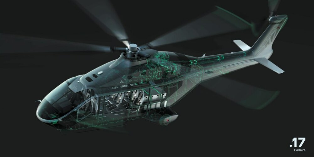

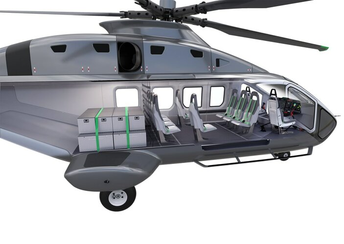

Hi folks,
on November 13, 2024, the new Russian helicopter project Heliburo HB.17 was unveiled first on Telegram.
This helicopter project, developed by Heliburo, is a medium-class helicopter designed for multiple roles, including cargo transport, passenger carriage, and fire support. First flight is planned to be conducted in 2027.
Maybe our Russian members can tell us, if this helicopter project is genuine and will have a future.
Edit:
HeliBuro is developing a new multi-role Russian helicopter - HB.17. Now the design of the rotorcraft is underway, and the first flight is planned for 2027. The helicopter is designed to carry 9 passengers (in a certified version) and various cargo. It is a medium-class aircraft with modern electronic equipment and a combined control system.
The HB.17 is planned to be equipped with one of the most reliable engines in the world, the VK-2500, with a payload of 2.5 tons. The use of one engine instead of two will provide high fuel efficiency: the flight range on the main tanks will be 950 km.
This makes HB.17 attractive to regional operators associated with subsidized transportation. The helicopter will also be of interest to government departments that require prompt transportation of cargo and personnel.
Sources (Russian and English):
Dear mods, if wrong topic, please feel free to delete this topic, or move this post to a more suitable topic. :)
