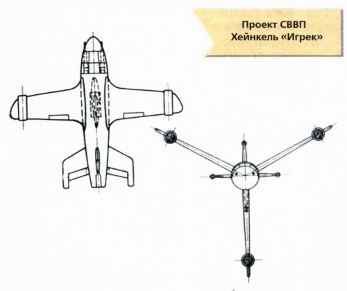

Heinkel "Y" (late 1944)
Rocket-powered vertical take-off interceptor.
The project would take off vertically, using the rocket engine (probably HWK 109-509A + 4-RATO / Startraketen 4 x SG34 /) When high acceleration to the speed at which the ramjet (Three Pabst pulsejets). Armament: 2 - MK-103. Spent fighting kit plane was used as Bachem "Natter" for ram attacks.
What a weight and size specifications are not available.
Source: E. Ruzhitsky «European aircraft vertical takeoff»

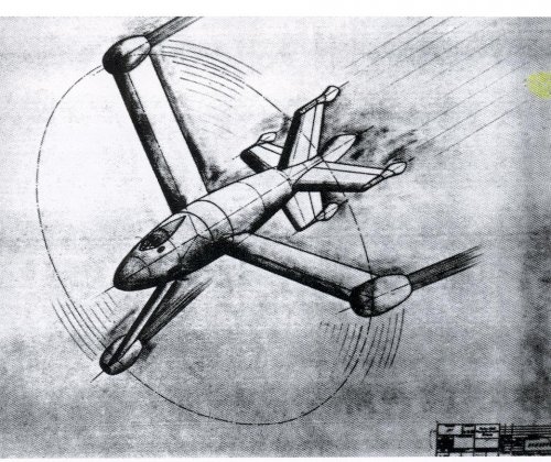

What an odd design.... Really awful forward visibility, likely uncontrollable with power on if one of the tip pulsejets is damaged or fail, the fixed Y-wing seems completely useless unless the idea was to turn without rolling. I can't see why this wing/engine arrangement would have been chosen over a conventional left-and-right wing and more inboard or fuselage placement of the engines.
I wonder if the source was much more than the artists impression attached above? Does the article say? The text above seems focused on the delta-winged design.
Not to bother anyone with my scepticism again, but the caption of the "Heinkel Y" speaks of "Triebflügel", so may it be just a misinterpretation of the Focke-Wulf Triebflügel ?

Yes, because the wings of the aircraft were part of a rotating ring assembly around the fuselage, and Heinkel's VTOL tailsitter fighter studies were the Lerche and Wespe.
I don't understand something with the triebfugel, how can the wing spins without the fuselage is spinning to? how the fuselage could be stabilized with this huge propeller?
It is not an engine in the fuselage that pushes the wings to rotate. It's the wingtip jets on the wings themselves.
So, in theory, there is no torque exerted on the fuselage.
I saw that, but, you hae always some friction (in wikipedia they say that you can stop it with controls, but, you must give a lot of power, how the fuel is put in the reactor, if it in the wings, is it not too heavy? An dif you haven't for any reasons the same angle, the same trust in the reactors, what happens?, i think it's not a viable project for these reasons, he is to big, and asking to much trust and he is not viable for the war (you have to shoot in the wings, or controls panels, and at this speed, it will be easy, and the circumference is enormous for a propeller, so you just have to shoot in the cicle for a godd time, annd you have an aircraft without stabilisation). It's to dangereous to have it for the war.
