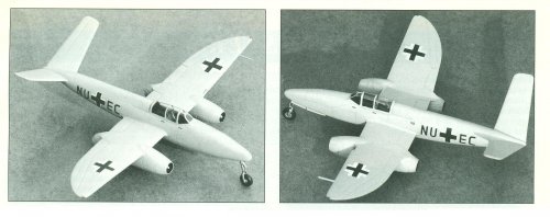

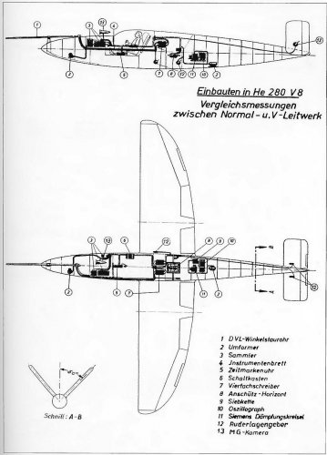

I found this two drawings in the internet. The website i don't remember.
Not much information, but i hope it's a little bit helpful. But the two drawings shown different butterfly tails with angle of 40° and 50°.
greets
Thank you very very much baja.
Perfect.

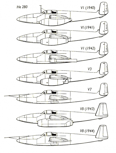

A bit late, but here's the profiles of the He 280 from 'Warplanes of the Third Reich'...
cheers,
Robin.
Many thanks robunos and airman.

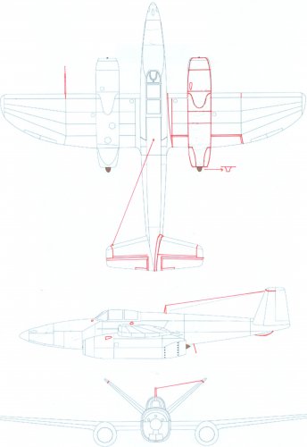

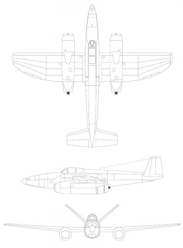

Just to run this past you...in progress...
Keyline 3-view of the swallowtail with Jumos.
Advice truly appreciated.
Many thanks
P
Thanks for the expert eye Justo.
What would I do without it?
P :)

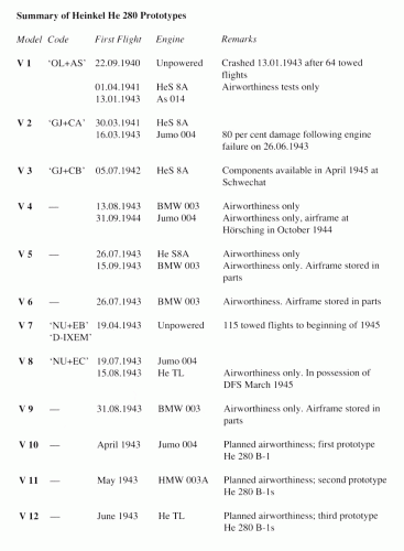

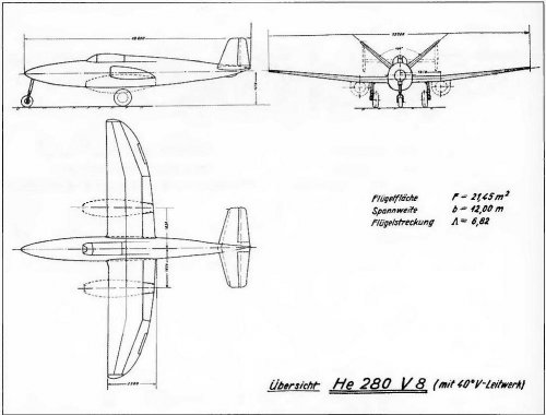

Only one of the nine prototypes, it would seem.
Strangely enough, my Waffen Arsenal #108 devoted to the He 280 doesn't have a single drawing or photo of the vee-tailed prototype.

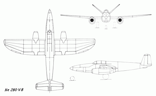

A three-view arrangement of the He 280 V8 and its vee-tail, from German Aircraft of the Second World War (Putnam):

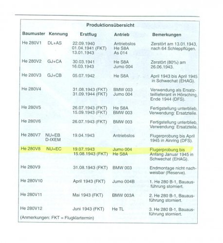

The list of He 280 prototypes from The Luftwaffe Album, Fighters & Bombers Of The German Air Force 1933-1945 (Brockhampton):
In "Heinkel Raketen- und Strahlflugzeuge" by Volker Koos, there is only a single small sketch of the He280 V8 with the v tail, indicting the fins were set at that point at 40 degrees up from vertical. fin span was not indicted, but appears to be slightly wider than the original twin tails. The book otherwise has a fair number of photos and drawings of your basic He280, both with HeS08s and unpowered gliders.

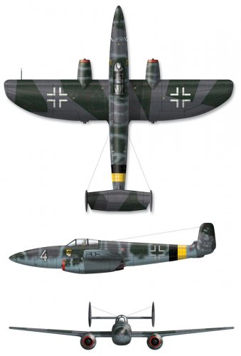

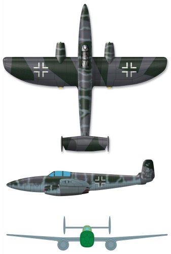

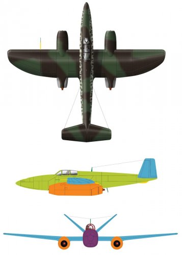

Progress report on both twin fin and swallow tail.
Antena mast needs adding to the twin fin....
Many thanks
P :)

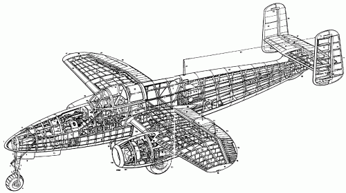

Have to say looking at those profiles and the cutaway brought back many memories as we ramped up for Vol 2 of this book. What was so annoying is this was virtually ready for print just prior to the company going under!
