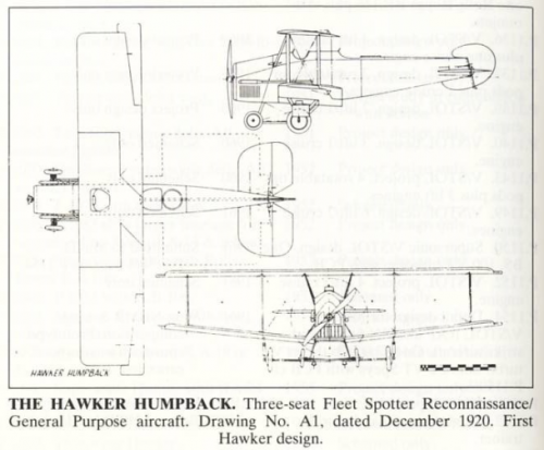

The Hawker Humpback was a three seat fleet spotter recce & general purpose Project,maybe
submitted to Spec. 8/20 ?.

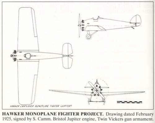

Here is a Hawker single seat fighter low-wig monoplane Project which intended for the
Spec. 25/25.
As far as I know 25/25 was not put out to tender, it was just issued to cover the first production of the AW Siskin III.
