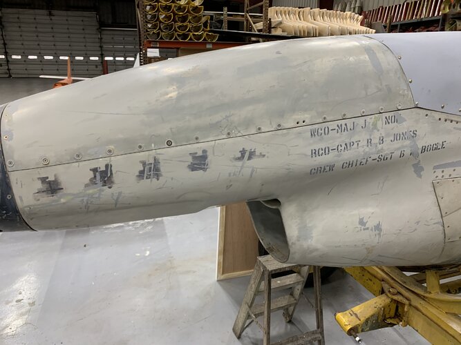

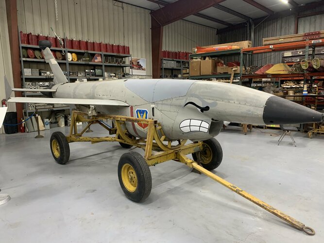

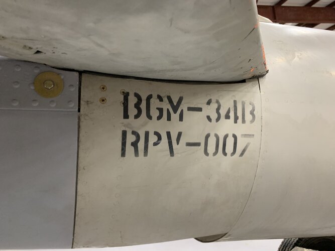

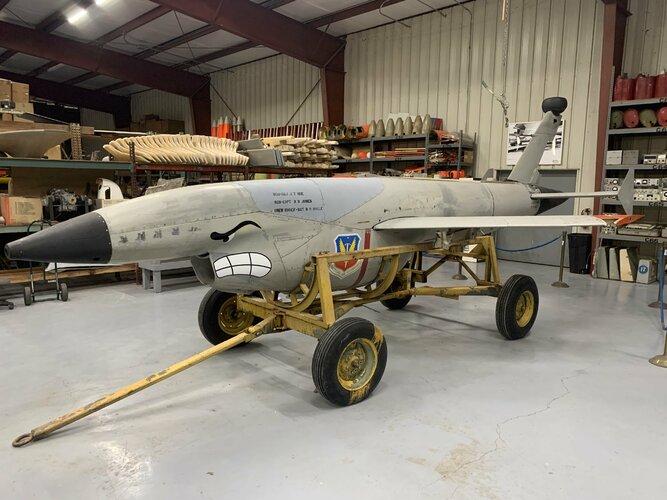

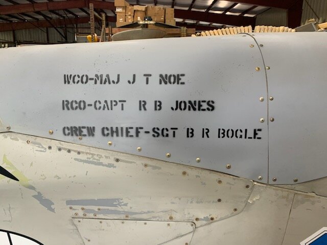

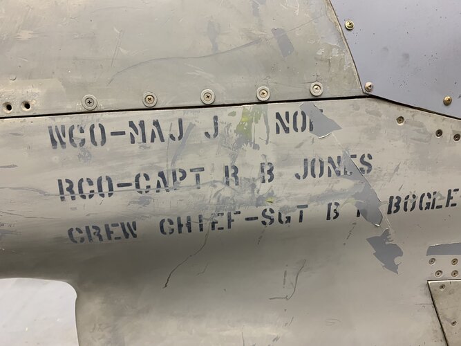

Hello, nice post! My grandfather was involved with all the Firebee stuff, and HAVE LEMON. LT COL Harold “Red” Smith. He was first drone SPO, deputy chief of RPV division at SAC. We actually have one of the BGM-34B’s in our museum,the only 34b known to still exist. Check out the videos page and you can see several videos of the have lemon program and Firebee strike drones in action!
