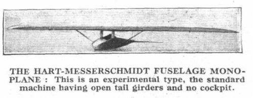

can anyone ID this Hart-Messerschmidt glider ?,it was from S series.
It is, what it is, I think, a glider constructed by either two persons, one with the family name
"Hart", the other "Messerschmidt", or maybe just one person with the double name "Hart-Messerschmidt".
It's still not clear to me, and still yet, I haven't found more information, besides those on the "Flight"
pages, but I hope it's clear, that this "Messerschmidt" had nothing to do with Willy Messerschmitt.
But on page 549 of that Flight issue, you can see this aircraft with the mentioned girder fuselage
and no "boat", that means without cockpit fairing. The early '20s were the heydays for gliding in
Germany, as construction of powered aircraft still was forbidden and there really were a lot of
constructors, just have a look into the list of the participants on page 548 !

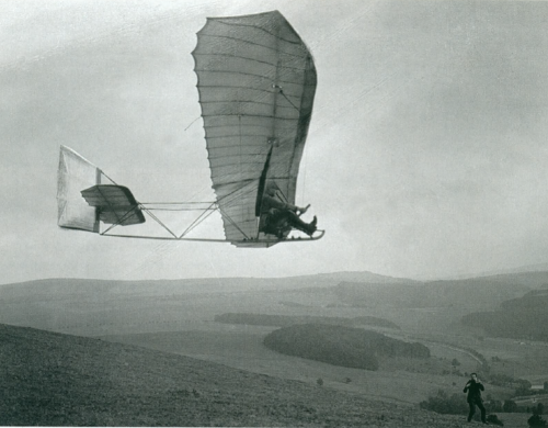

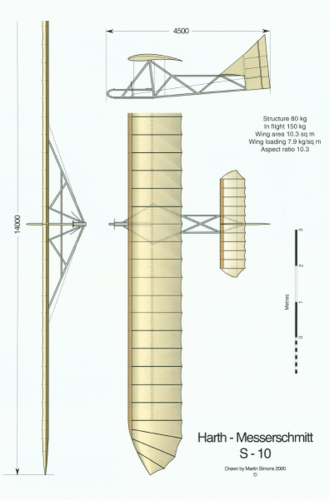

The 'Messerschmidt' in question is THE Willy Messerschmitt!...
Friedrich Harth, along with a young Messerschmitt had been working on gliders for several years. On September 13th,1921 Harth, flying the Harth-Messerschmitt S.8, acheived a flight of 21 minutes duration. However the flight ended in a major crash, Harth sustaining serious injuries, from which he never properly recovered. In 1922, at the Wasserkuppe Meeting, Messerschmitt produced the S.10, however other machines were more sucsessful, and Messerschmitt eventually moved on to powered aircraft.
Several of these early machines used a novel control system, the wing being pivoted like that of a Flying Flea, rather than using elevators, or a slab tailplane.
source, 'Sailplanes 1920-45', Martin Simons, Ekip, 2006 ISBN 39806773.4.6 pp. 17-20.
cheers,
Robin.

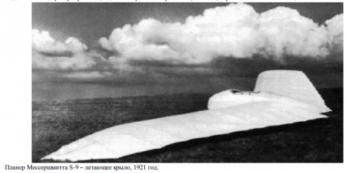

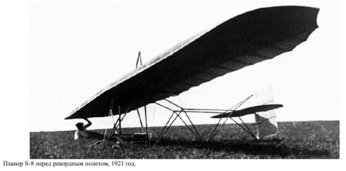

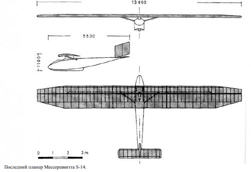

here is some S gliders.
неизвестный мессершмитт
