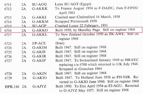

In the book "Miles aircraft since 1925" by Don L. Brown, Putnam 1970, the Messenger s/n 6716 registration G-AKK0 is mentionned to have been built in 1950 by Handley-Page.
But there is no indication concerning a wing modification or else.
So it is a "could be"!

That was my first thought too, but unfortunately the Handley Page Putnam has the HP93 dated as 1948.
Brown's appendix was my first go to "of course he'll have noted it" ... but no such luck. Both AKKO and AJYZ are noted as "built by HP" but in 1950, but surely the fitting of the dufaylite wing would rate a mention somewhere?
1948 was a tumultuous time for Miles with bankruptcy and the take-over by Handley Page, but even Barnes' HP Aircraft Since 1907 only mentions that the H.P.93 existed.
