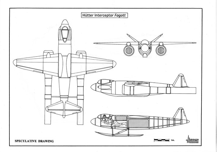

Hütter Interceptor Fagott

The Hütter project powered by two As 044s would need 1,766 liters of fuel for a 20-minute flight.
Fuel needed for 20 minutes endurance:
-With one As 014, 586 liters
-With two As 014, 1,173 liters.
-With one As 044, 883 liters.
-With two As 044, 1,766 liters.
The combat range and service ceiling of the model was considered unacceptable by Technisches Amt and the proposal was dropped.
The project was rejected because at that time the Luftwaffe needed high-altitude interceptors with heavy weapons to fight against Allied bombers and a low-level pulsejet fighter would not have been useful against the Allied tactical fighters Tempest, Typhoon and Thunderbolt that surpassed it in speed.
