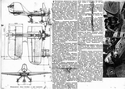

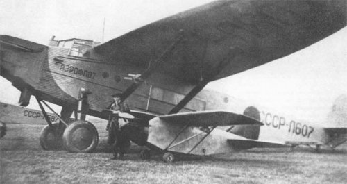

I attach here a photo of Oktyabryonok side-by-side with popular Kalinin K-5 airliner. You can see some more photos and a 3-view here: http://www.airwar.ru/enc/law1/oktyabrenok.html.

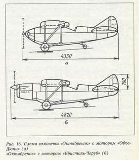

2) first with 27-hp Aubier-Dunne engine
and the second option with 30-hp Bristol Cherub engine.
from: "Aircraft MAI."

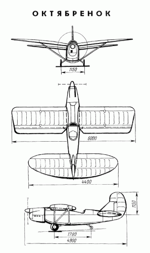

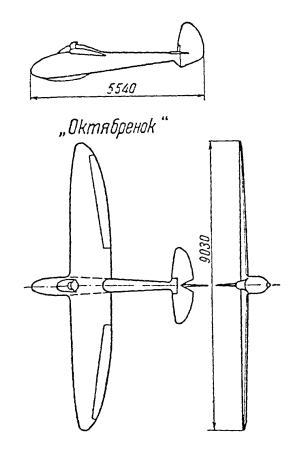

A clean three-view of the Oktyabrenok:

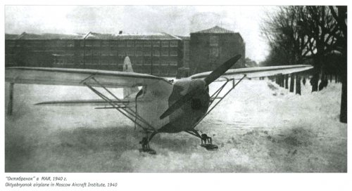

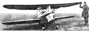

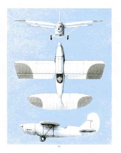

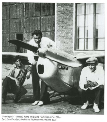

Grushin's Oktyabrenok, seen in 1936 (with Grushin on the right) and in 1940 at the Moscow Aircraft Institute (or MAI), plus another three-view:
