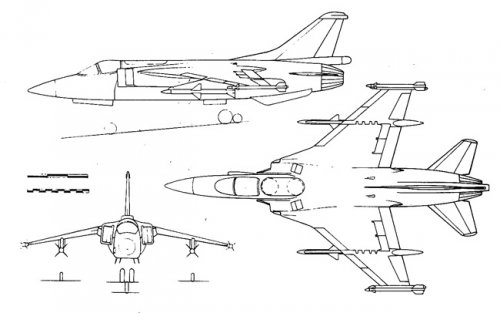

3 view from Grumman entry, the Model 607
Grumman Model 607
Designed for the Sea Control Ships, proposed in 1971. Powered by a 15,650lb/27500lb PW JTF22A-30B lift/cruise turbofan with a conventional rear nozzle and a swivveling nozzle on each side of the rear fuselage, annd 2 x 11,535lb Grumman GLE-607A liftjets mounted vertically behind the cockpit. Armament was a cannon in the port leading edge, Sidewinders on wingtips and Sparrows under wing.
Span: 9.6m (6.65m folded)
Length: 15.74m
Height: 4.88m
Wing Area: 33.91 sq m
Empty Weight: 8.711kg
VTO Weight: 13,936kg
Max Weight: 16,652kg
Max Speed: Mach 1.2 sea level, Mach 2.0 at altitude.
Combat endurance: 1.72 hours at 555km (conventional takeoff)

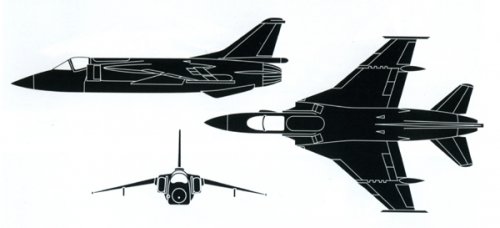

Was there ever any suggestion of what sort of radar this design would have used? The nose to me has always seemed short and on the space-limited side........

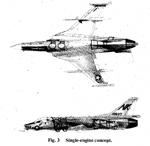

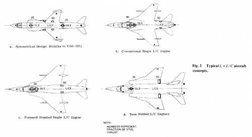

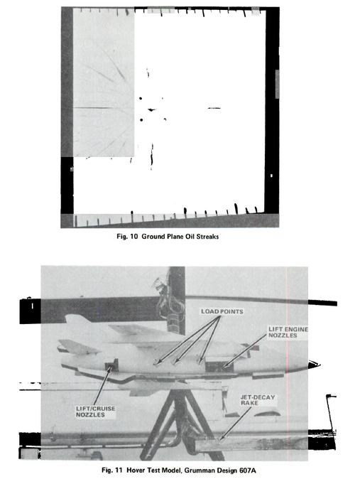

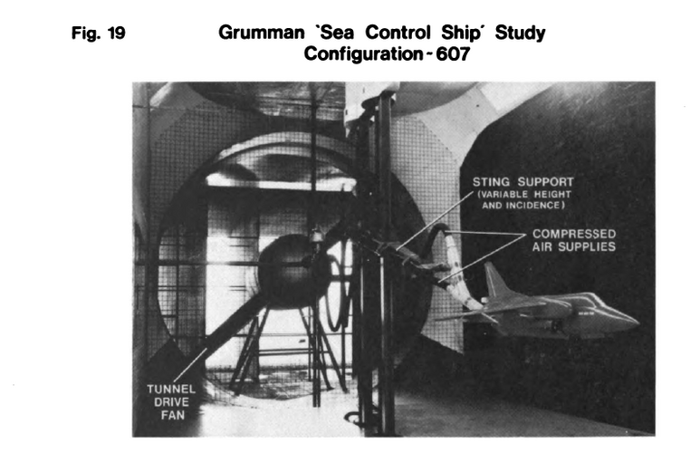

it seemed to be there is a two variants from Grumman G-607,the second one is
bigger and has a stretch fuselage;
http://arc.aiaa.org/doi/abs/10.2514/3.58753?journalCode=ja
