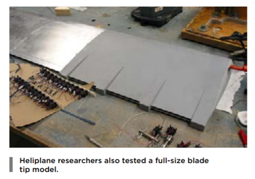

The Groen tipjet design is pretty unobtrusive; you really can't see the jets in photos of models at this scale. It's not like the pods on the Rotodyne, for example. Here's a picture of the tipjet design they tested for DARPA, extracted from that Vertiflite article hosted on the Skyworks website. Not easy to interpret, but I think it's basically a row of small ejector jets in slots at the trailing edge of the blade tip.
