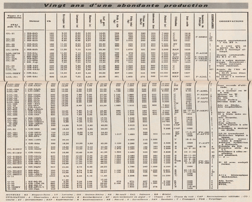

There were two basic forms of Gourdou-Leseurre designations - Type Letters and Alpha-Numerical listings.
Known type letters range from Type A to Type M. Type letters are sometimes rendered in lower case (eg Type a). Subtypes were given number suffix (eg Type B1). Type letters were presumably design office designations since alpha-numerical designations were also (or later) applied to these aircraft.
Alpha-numerical designations from 1917 to 1925 had a GL prefix. From 1926 to 1928, Gourdou-Leseurre was the design office for Ateliers et Chantiers de la Loire. During that period, GL designations became LGL (although, here, I have retained the GL form for simplicity sake). After 1930, the use of GL prefixes resumed until 1938 when G designations appear for Gourdou designs.
In normal French fashion, airframe developments receive a suffix number -- so, an improvement upon the GL 33 (aka LGL 33) is designated GL 331 (LGL 331). The suffix Hy (or HY) for Hydravion is added for floatplanes.
In published sources, GL numerical designations are rendered with a space, a period, or a hyphen. Individual airframe numbers follow after a hyphen. Military suffix letters/number designations follow with or without spaces or punctuation (I have used a space with a period between the role designator and crew number).

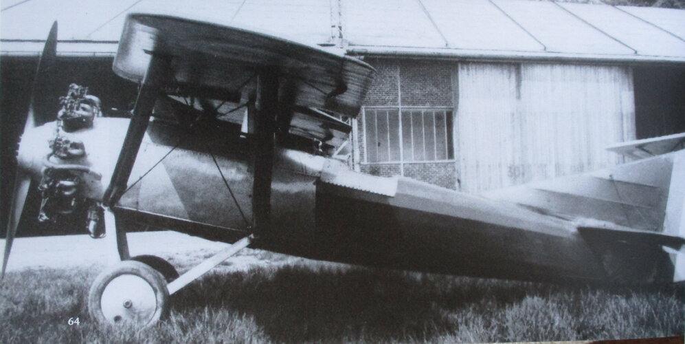

GL 1 --- 1917-18 fighter prototype, parasol monoplane, 1 × 180 hp HS.8Ab, 1 built
-- originally designated Gourdou-Leseurre Type A, led to Type B/G 2 series
GL 2 --- 1918 parasol monoplane fighter, 1 × 180 hp HS.8Ab, 20 built
-- originally designated Gourdou-Leseurre Type B

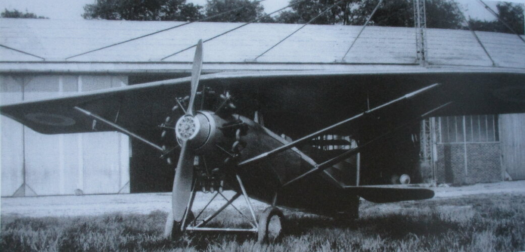

GL 31 - 1922 parsol-wing single-seat fighter, 1 x prototype
- GL 31: GL I racer derivative, 4 x 7.7mm machine guns
- GL 31: 1 x 420 hp Gnome-Rhône 9A radial, span 12.20 m*
-- Some sources say never completed (finished as GL 32?)
-- * Some list span as 10.50 m (poss. for I 2 / GL 30)

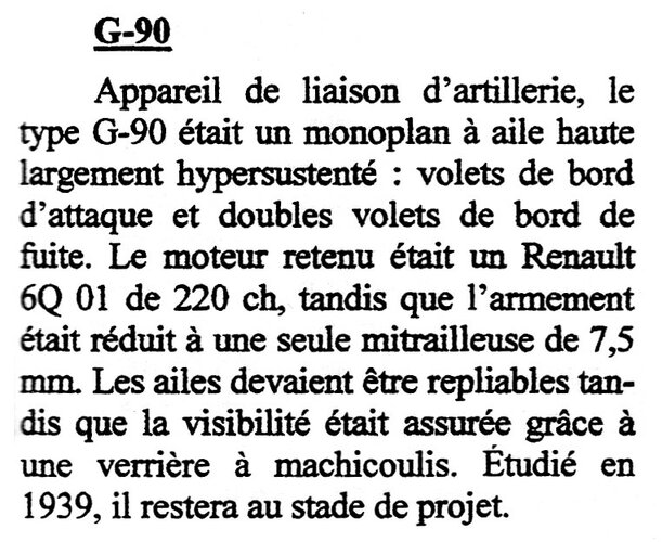

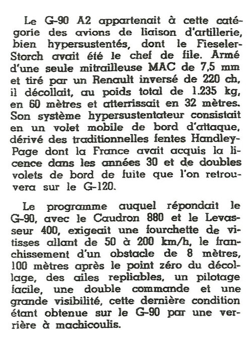

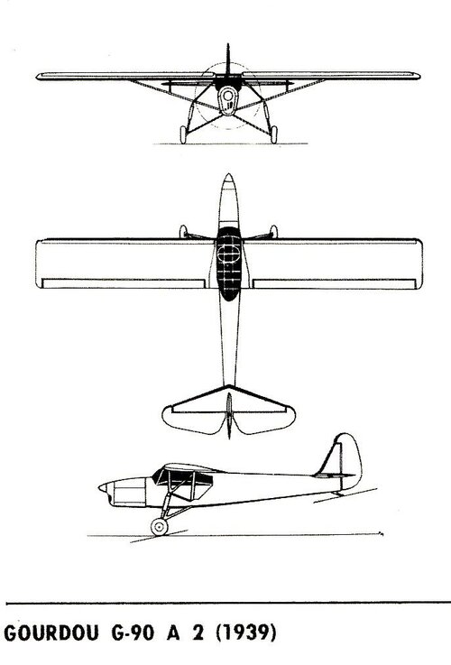

G-90 - [Project] 1939 high-wing STOL cabin monoplane, 220 hp Renault Bengali 6Q
-- G-90: aka G-90 A.1 (Armée) artillery spotter, copy of the Fieseler Fi.156

Apophenia said:
A minor mystery (for me anyway) is the CAP.2 alternative designation for the high-altitude GL 40/Type G. Does anyone know the meaning of that CAP acronym?
"CAP.2" or "Cap.2" is a role designation used by the French Army for a shortlived program of two-seat high-altitude fighter and reconnaissance aircraft. I don't know what is the exact meaning of the CAP initials (maybe "Chasse d'Armée et Protection"). Specifications for this program were published in 1919, they asked for 200 km/h at 7,000m and 8,500m ceiling. These performance figures implied the use of a Rateau supercharger. The program was officially abandoned in 1920, but prototypes were nonetheless made to this specification in 1921, including the Gourdou-Leseurre GL.50/type F and GL.51/type H.
However the GL.40/type G was not related to this program. It was a single-seater and was made to a different C1 specification, dated 1921.
Source: L'aviation de chasse française 1918-1940 by Jean Cuny & Raymond Danel.

I think there is some confusion over the dates & designation of the racer built to compete in the 1923 Coupe Beaumont. This aircraft was built with a retractable undercarriage & was powered by a Bristol Jupiter engine. According to Icare 230 ("Les Avionneurs Charles Gourdou & Jean Leseurre") page 62, this machine was designated GL I & first flew on 1st February 1923. Two further projects followed, the I 2 (alias GL 30) also with retractable undercarriage (not built) and the I 3 which was built as the GL 31.
Now if I search for GL30 I get a reference to a racer built in 1920 which had a retractable undercarriage & a Bristol Jupiter engine & which flew the Coupe Beaumont course in 1923. So this is the same aircraft but the date given of 1920 is wrong & it would appear, from Icare, that the designation is wrong as the GL 30 was never built. The correct designation of the racer should be GL I.
The list of aircraft from Aviation Magazine given in a previous post supports this, except that it doesn't give any designation for the racer. It does, however, give the correct year, 1923, & immediately below, it lists the GL 30 as not being built with a project year of 1924.
So it seems that the Gourdou-leseurre list should be amended to reflect this information & I would be interested to hear any comments.
Thanks for that. A Nov 1923 edition of Flight describes the "Gourdou-Leseurre Monoplane" in some detail but never actually identified the designation or model type. Others seem to have applied the 'GL 30' after the fact.
I also see that there is some understandable confusion out there between the GL 1 (aka Type A or GL a) and GL I.
I have made the changes to both 'Type' and 'GL' designation lists. Hopefully, whoever routinely pinches SPF stuff without accreditation for Wikipedia will now update their pages too ;)
Good. I also notice that there is doubt about the GL 31 being built. From the same source as I cited above (Icare 230) I have attached 2 photos of the GL 31. The second clearly shows differences from the LGL 32 no 01.
