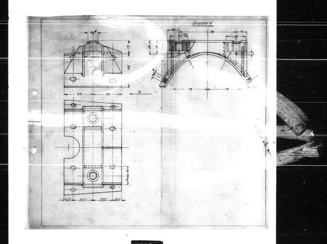

Incidentally, the drawing mentioned in the report is appended, but I don't know if it really helps much (see below). I should emphasise that the weird markings you see are on the original drawing!
