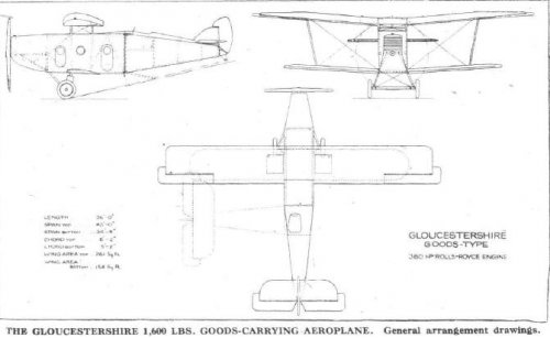

it is the first time in my life,that the Gloster (Gloucestershire) designed
aircraft like this.
http://www.flightglobal.com/pdfarchive/view/1922/1922%20-%200087.html?search=aircraft
Could this be the Gloster Goodwood project, a Freight Landplane submitted to Specification 34/24?
Good find Hesham! Would this be the first swing-tail design for commercial cargo aircraft?
[BTW, Harold Bolas' US patent 1,304,652 (27 May 1919) for the swingtail Parnall Panther is available online, does anyone know where to find details of his 1917 British patent?]

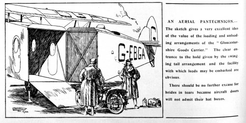

always from flightglobal page 87-88 : i have rename file gloster goods
  • glostergoods.pdf

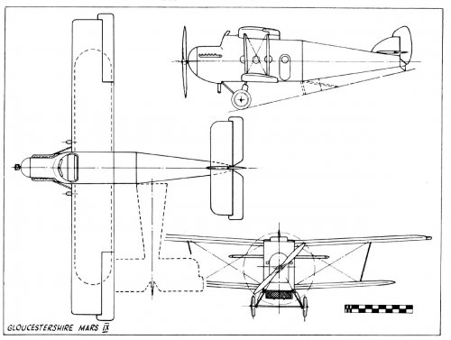

Stephane,
The only information I have on this project comes from James' Putnam volume Gloster Aircraft since 1917. All other sources seem to be based on this.
James says that original project, in 1922, was called the Mars VIII designed to carry nine passengers and powered by a 450hp Napier Lion. The Mars IX, also 1922, was a slightly smaller version of the Mars VIII to carry seven passengers and powered by a 360hp R-R Eagle IX. There is a 3-view of this project. The Goods-Type illustrated in Flight is basically the Mars IX with a modified radiator installation (in front of the engine rather than under the nose). The Goodwood was larger than either of these projects as the total weight is quoted as 10,000lb (6820lb for the VIII and 5615lb for the IX) and the engine an unspecified 460hp. The only British engines with that power available in 1925 would have been the Napier Lion of Bristol Jupiter.
From Aeroplane Feb 15th 1922
Now the plot thickens...
I've just looked at Putnam's 'Gloster', and the description of the Mars VIII says this :-
"The pilot had an outstanding view from a cockpit on top of the fuselage in front of the upper mainplane..." (my bold)
The drawing of the Mars IX, see below, also has the cockpit in this position, whereas the cockpit of the 'Goods Type' is in the traditional position behind the cabin. Also, the fuselage of the Mars XI ,and by inference, the Mars VIII, completely fills the gap between the mainplanes, whereas the fuselage of the 'Goods Type' doesn't.
I'm with Skyblazer on this one, the aircraft illustrated upthread is IMHO, not the Mars VIII...
But I could be wrong... ::)
cheers,
Robin.

The inference that the Goodwood is larger than the Mars VIII and Mars IX is from the weight, 10,000lbs for the Goodwood, 6,820lbs for the Mars VIII, and 5,615lbs for the Mars IX, see Schneiderman's post above.
Regarding the Mars lineage, the Mars series was very heterogeneous, covering everything from single-seat fighters and racers, up to these transport aircraft. The only common factor seems to be the aerodynamic arrangement, most of the Mars series using the Gloster H.L.B, High Lift Biplane, configuration.
cheers,
Robin
