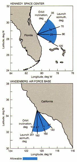

4. RTLS has no bearing on the matter. It is the launch trajectory that determines launch location and that is the Cape and Vandenberg.
5. Because of the limited azimuths from the launch sites. There are areas in world that can be reached on the first orbital pass.

4. The same ascent trajectory safety and launch azimuth restrictions exist regardless of reuse/RTLS or expendable. Still can't fly a Falcon 9 over populated land. The F9 can go more south from the Cape than is shown here.
5. See #4. Suborbital in only that engine shutdown is before orbit is achieved. There is no depressed trajectory.
