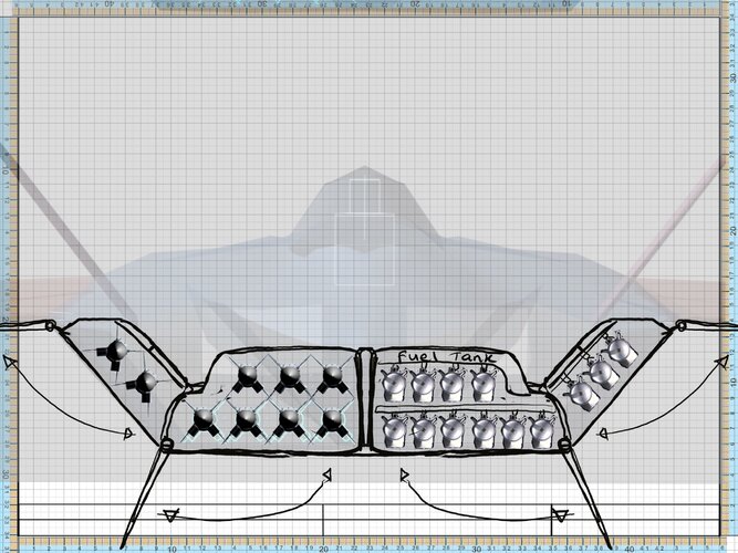

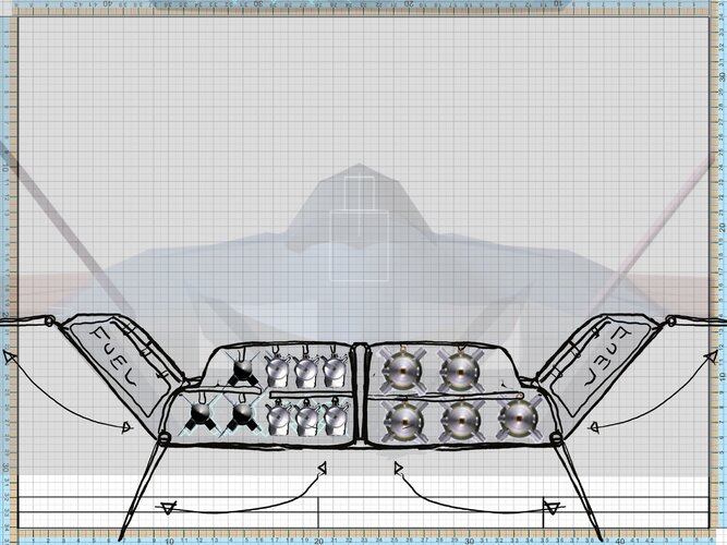

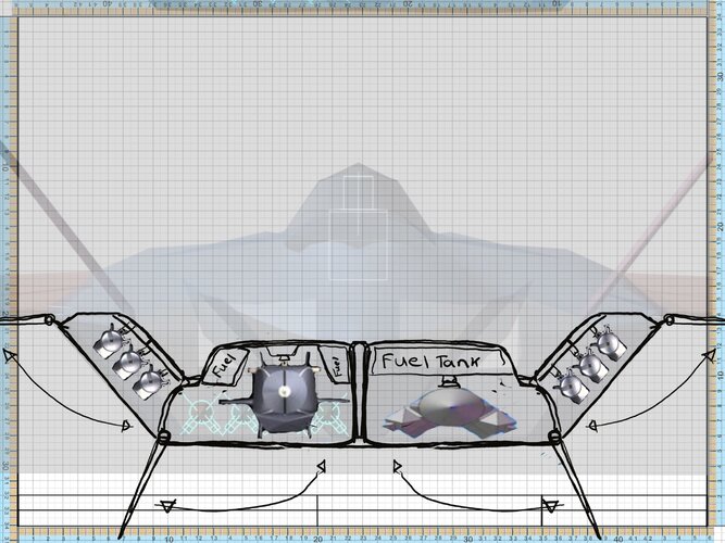

That why I want happy see ASM-3 internal weapon bay focus regard not include use FCASW might too big depth for internal bay
0.65 x 0.9 x 5.2m compare to ASM-3 350mm (35cm) x 900mm (90cm) x 60000mm (6m)
I will try do draw and rough to visual internal bay Use picture avode as baseline I will Use procreate app as I don't have 3d software.
Sorry waffle about why I want see GCAP use ASM-3 as basic internal bay.
These option will be good
Front view
I will try do top version I need find pic top
Paveway iv / spear 3 (and ew) / meteor / asw / storm shadow (similar dimensions of FCASW)

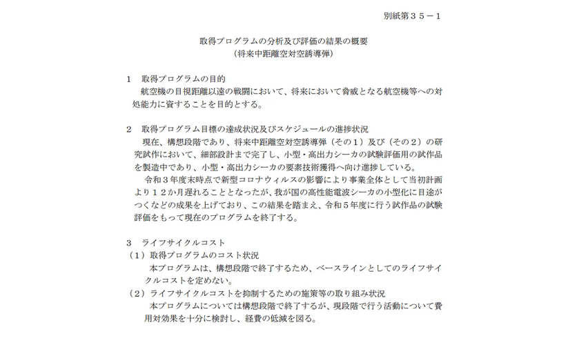

Also the info that we do have is very scarce, but the one thing that was confirmed from Japan's side is that seeker miniaturization was successful.
令和3年末時点で新型コロナウイルスの影響により事業全体として当初計画より12か月決着することとなりましたが、国内の高性能電波シーカの化に目途が小型つくなどの成果を上げております、この結果を踏まえ、令和5年度に行う試作の試験評価に従って現在のプログラムを終了する。
As of the end of 2021, the entire project will be completed 12 months later than originally planned due to the impact of COVID-19. However, we have achieved some results, such as seeing progress in miniaturizing high-performance radio seekers domestically. Based on these results, we will end the current program following the testing and evaluation of a prototype in 2023.
So if the Japanese seeker was too heavy and causing problems then why would Japan be talking about seeker miniaturization being one of the achievements of the program? I still think that Thales Aero who is the main contractor for the Meteor seeker not liking being shafted out of their main role in the program with no say from the French side is a much more reasonable scenario.
We also know that JNAAM was cancelled right before practical test flights with official termination after the fight launch, so this would have to assume that
