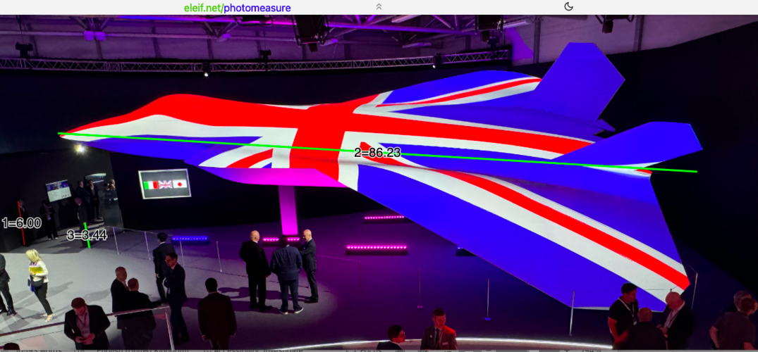

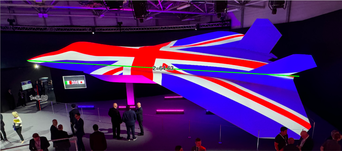

Hes revised his estimate to 65ft (19.8m) which is still almost a meter longer than an F-22. Not sure I have much confidence in it, someone else in the thread is suggesting 19.0m based on canopy scaling to the J-20 but we have seen the Tempest mock-ups actually have unusually large cockpits with massive canopy panes.
I expected the GCAP to be 1-2 meters longer than Kaan but in fact Kaan is 0.4 meters longer than the GCAP! o_O (acc. to @paralay) This roughly means that the MTOW might not be as much as we've thought.
I reckon the American and Chinese 6th gens are going to be longer and heavier than that.
Yes he's back away from it, 10ft shorter than an F-111
It's a plastic model. Pointless trying to speculate over an exhibition display.
1:1 scale means nothing if you don't know what it's scaled against and BAE already bragged that they can alter the design overnight, so making the model takes more time that it does to doodle it in CAD. Probably takes longer for the procurement department to set up the contract to tender the model than it does to doodle in CAD.

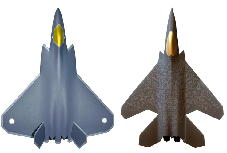

Interestingly, it's actually basically identical to the old GCAP model in all respects (relative dimensions, wing location & sweep, front & tail sections etc), except for that wing trailing edge.
Also added a comparison to Dassault's NGF for good measure (though exact relative scale is unknown). GCAP is clearly broader and with a much bigger wing area. NGF doesn't appear to be much shorter, but is much more slender (typical Dassault design), and with that distinctive YF-23 style "boat tail".

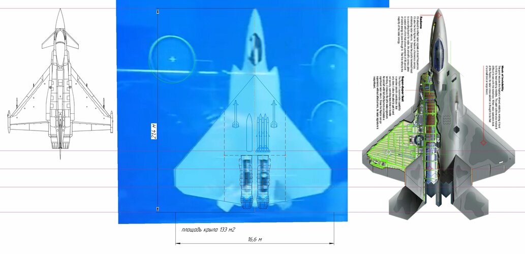

the wing area is 133 m2
the dotted line in the diagram shows the F135 engines
It's 19.8 m long (fuselage length, excluding overhang of tailfins), and has a span of 15.6 metres.

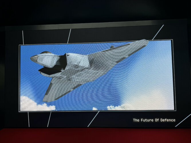

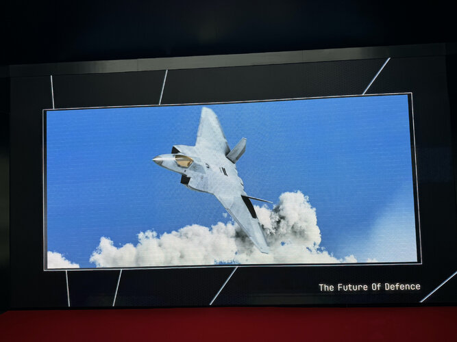

Some surface detail including bay locations from a Leonardo video...

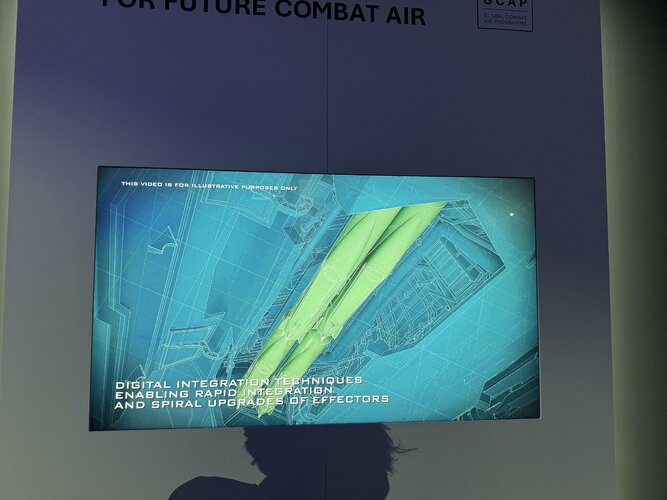

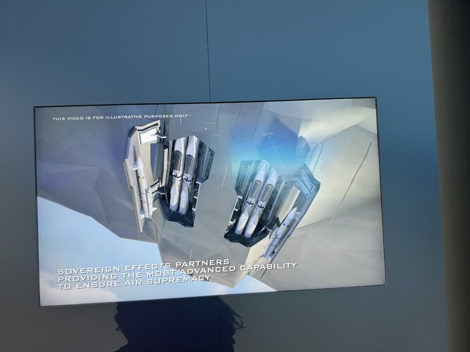

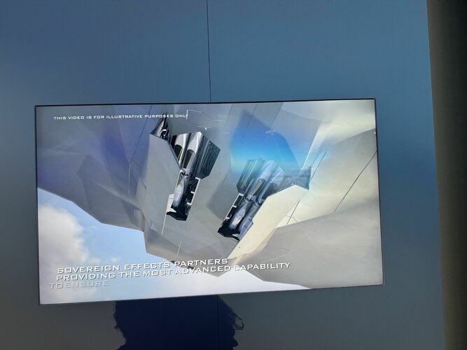

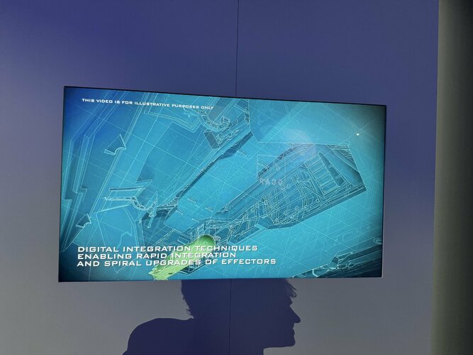

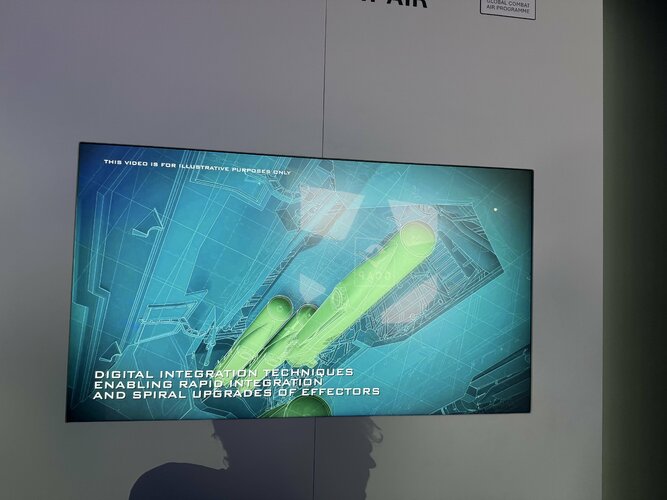

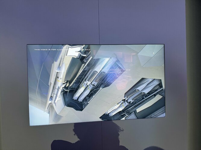

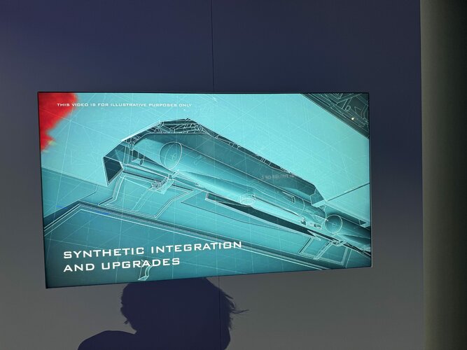

And some bay details from an MBDA video

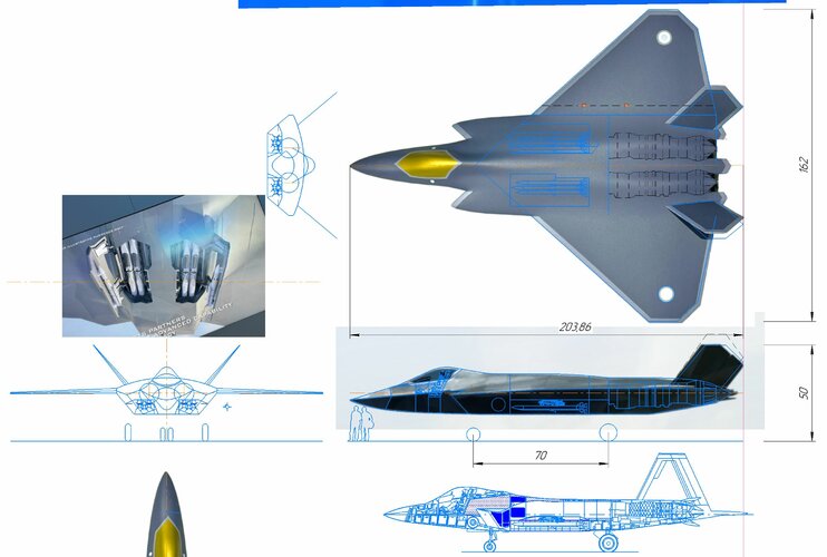

length 20.4 m
wingspan 16.2 m
height 5.0 m
wing area 122 m
2F136 engines 2 x 19500 kgf / 12750 kgf
maximum take-off weight 39000 kg
normal take-off weight is 28,000 kg
fuel 12,000 kg
combat load 8000 kg
flight range is 3,300 km.

With massive respect, I believe that these length and span dimensions are wrong by about 4%, while height cannot be accurately assessed until there's a useful picture of the aircraft 'gear down'.
