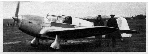

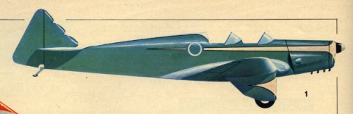

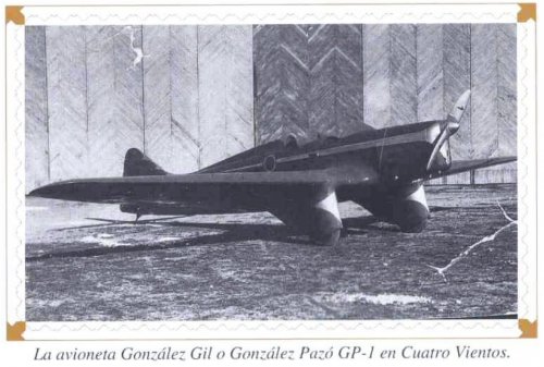

First came the GP-1 designed and built by Arturo González Gil and José Pazó Montes. The first prototype (EC-VVV) was blue-gray with silver cheatlines (see pictures posted below). It first flew in June 1934 . (Note: it is quite clear that the so-called "Gil-Pazo No.1" discussed in above posts and supposedly flown in 1932 actually does not exist.)
The prototype originally had a Cirrus engine that was replaced by a Walter Junior 105 hp, which was a mandatory equipment for the training aircraft competition organized by the Spanish military in 1935. It won the competition against three other competitors: the Hispano E-34, Adaro 1.E.7 Chirta and Loring X.
This prompted an order for 100 aircraft, whose production was undertaken by AISA (ex-Loring). Because of the civil war, the number of aircraft actually built is not known exactly, but is supposed to be about 40. About 30 aircraft survived the conflict and were used by the military and by aeroclubs.

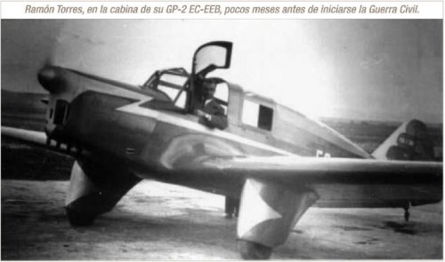

The next model was the GP-2 two-seat cabin aircraft, with a DH Gipsy Major 130 hp engine and larger fuel tanks. The only example whose existence is confirmed was registered EC-EEB and owned by Ramón Torres, who made long distance flights with it in early 1936. Some sources mention a second aircraft, but its existence is unsure.
The only picture I've found of the original two-seat GP-2 is that reproduced below, from the book by Velarde:
http://www.fio.es/velarde/
(Many pictures supposedly showing a GP-2 actually show something else, like a GP Especial, a GP-4, or a GP-1 modified with a makeshift cabin.)

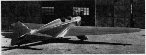

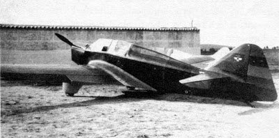

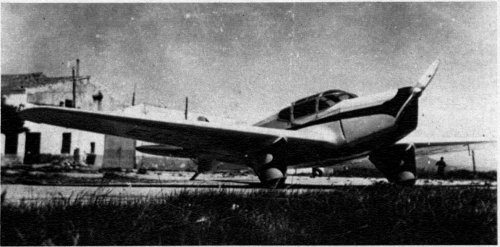

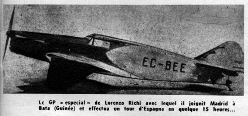

There was a single-seat variant, the GP Especial, of which two were made:
- EC-BEE, owned by Lorenzo Richi, who flew from Spain to Equatorial Guinea in January 1936 (two pictures below)
- EC-FFB "Numancia", owned by José Vélaz de Medrano, who planned to cross the Atlantic with it (no picture found in original condition)

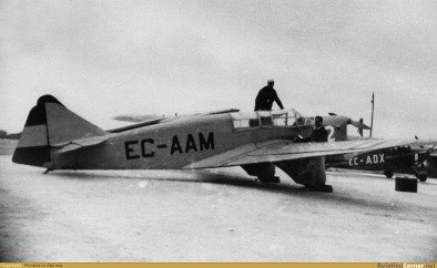

(Recent books distinguish the two-seat GP-2 and single-seat GP Especial as two separate models. The name GP-2 Especial is also found, and the single-seat aircraft are counted among the GP-2 in the article by Dario Vecino. At the time, those aircraft were sometimes called GP-1 in the press, by analogy with the standard military trainer.)
During the war, EC-FFB was registered EG-042 with the Republican air force, and was modified with a second open cockpit at the front. After the war, it was re-registered EC-AAM and a makeshift cabin was made to cover this additional cockpit.
Details of this aircraft are found in this website: http://mchuliaq.blogspot.fr/2014/09/el-golpe.html
and good pictures of the aircraft as EG-042 and EC-AAM are found here (smaller reproductions posted below):
http://www.aviationcorner.net/gallery_en.asp?registration=EG-042
http://www.aviationcorner.net/gallery_en.asp?registration=EC-AAM

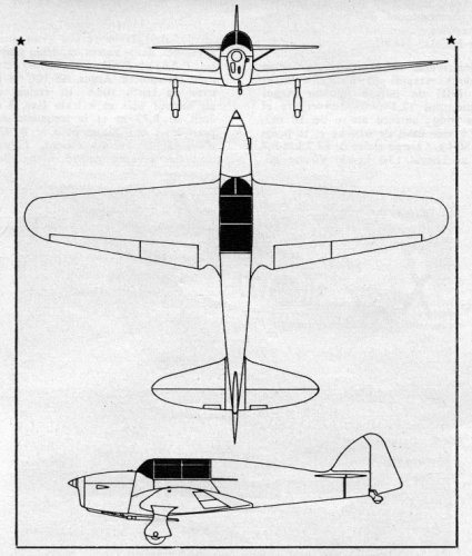

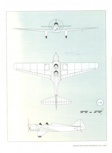

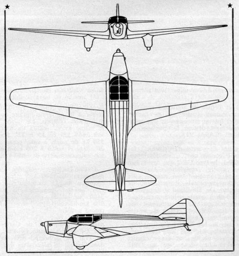

This is a drawing of the original two-seat GP-2, found in the book by Velarde.

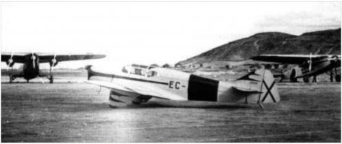

No record has been found of a GP-3.

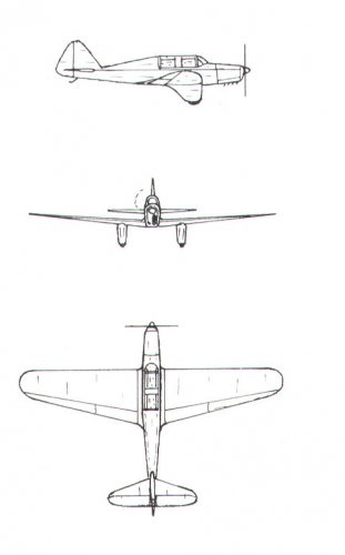

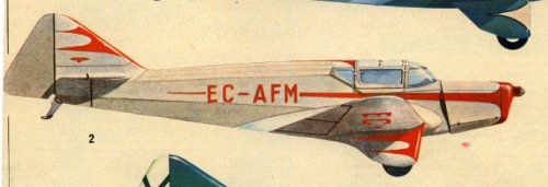

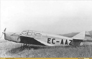

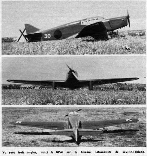

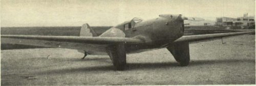

The next model was the GP-4, a four-seat cabin version. Engineer Ricardo Valle participated in the design, with new fuel tanks and improved shock absorbers.
Only one aircraft was made, registered EC-AFM, in silver gray with red registrations and cheatlines. It was impressed by the Republican and a red band was painted at least on the fuselage. José Pazó used it to join the Nationalists in September 1936. (Arturo González Gil had opposite political views and died fighting as a foot soldier with the Republicans.)

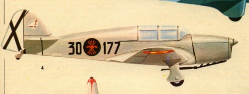

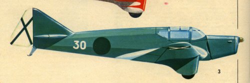

The GP-4 was then used by the Nationalist air force with the code 30-20, painted in dark blue according to Dario Vecino. After the war, it became civil again as EC-AAZ, officially registered as a "GP-2".
Some pictures of the aircraft can be found here:
http://www.aviationcorner.net/gallery_en.asp?registration=EC-AAZ
http://www.aviationcorner.net/gallery_en.asp?registration=EC-AFM

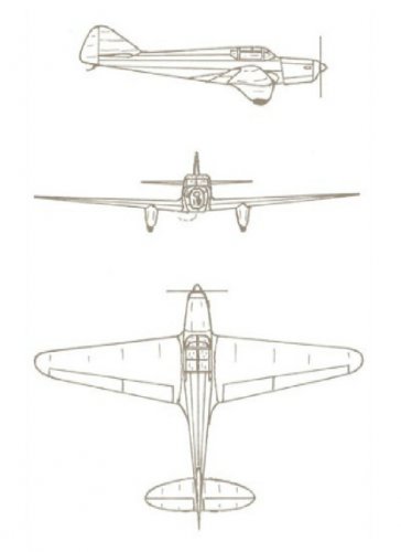

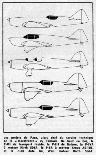

After he joined the Nationalist side, José Pazó became chief engineer at the Maestranza (maintenance center) in Tablada, Sevilla. He studied several aircraft projects:
- the P-III "liaison" four-seat cabin aircraft with Argus As-10C 240 hp engine and fixed spatted gear
- the P-III "fast transport", a single-seat record aircraft with Hirth engine (apparently an HM-8V 225 hp) and retractable gear (similar to that of the He 70), studied for Nationalist ace García Morato for possible record attempts after the war
- the P-IV two-seat tandem cabin aircraft
- the P-IV A, similar to the P-IV with two open cockpits
- two further single-seat record aircraft for García Morato, evolved from the P-III "fast transport": the P-5 A (with Argus As-10 C) and P-5 B (with Hirth 506 A), with a provisional fixed gear that would have been replaced by a retractable gear after the flight tests.
The designs were influenced by German aircraft like the Klemm or Taifun, and used German construction standards (instead of French or British standards on the earlier GP).

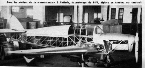

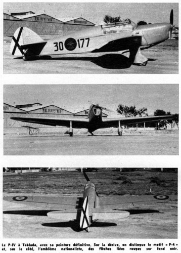

The only aircraft that was actually built was the P-IV two-seat cabin model. It first flew unpainted in 1939, and later received the military registration 30-177 and was painted light gray, like the Buckers.

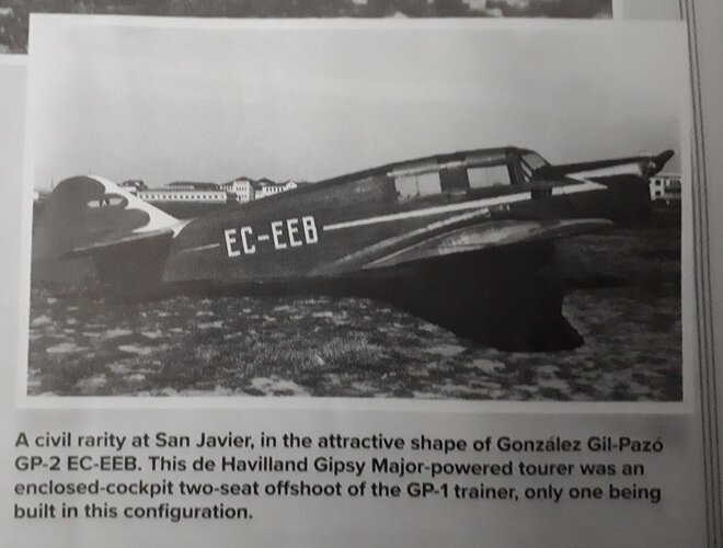

There is a photograph of the GP-2 in this month's Aeroplane Monthly (April 2022 issue).
It is part of a selection of 1930s Spanish Navy aircraft photographs submitted by reader Santiago Ferrer Jover of his grandfather's snapshots from his time in the Aeronautica Naval.
