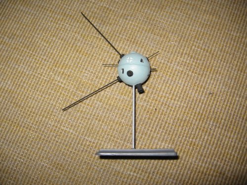

Hi, Guys! Here is what i found on e-bay:
Short info text: Already, during the early 1940's, Wernher von Braun had the vision, to have satellites orbiting earth (which would have had pure military purposes during that times). First trials with such a project, which was called an "Artificial Moon" were to be done from 1944 onwards.
First studies showed a spherical satellite, weighing in at 200 kg, which was to be sent into a low earth orbit by a three-stage rocket consisting of a EMW A-10/A-4/A-5 combination.
The second project, worked out by the "Kammler Group" (headed by SS-General Hans Kammler) in Peenemünde (Germany's rocket development center at the Baltic Sea), the "Satelloid", was also a spheric design and was to be equipped with cameras and radio antennas. Flight ceiling was to be 500 km and the "Satelloid" was to have an internal power unit also, which would have been used for course corrections.
In Kochel (an Upper-Bavarian City in the Alps), a reduced scale mockup was built for wind tunnel tests.
The oncoming end of WW II and various unsolvable problems with transportation meant that all work ceased then. Post war develpoment based on captured German data led to the development of "Vanguard" and "Sputnik".
So this project seem to be plausible...
All this story is a fake with the only purpose to provide a plausible history as background to such what if model.....
I could sell you a preserved piece of dog crap on EBay and state it's moon rock from Apollo 11. Doesn't mean it actually is.

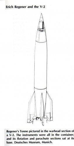

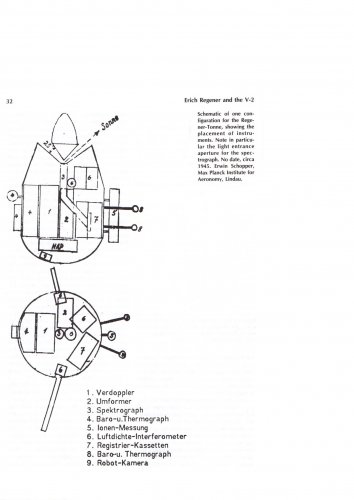

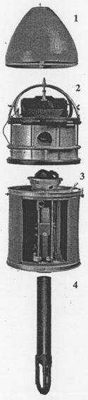

Erich Regener was researching about ionisating cosmic radiation already during the '30s.
High-altitude balloons could reach an altitude of up to 30 km. Atmospheric data from those
altitudes and, if possible higher, were of interest for the team around Wernher von Braun,
too, so the project was born for a capsule (the so-called "Regener-Tonne" Regener Barrel),
carrying instrumentation for gathering flight data of the A4/V2 up to a height of about 50 km,
from where it would return via parachute. A kind of sounding rocket, far away from a satellite,
but I agree with Justo, that it may well the origin of the story about a "German space satellite".
For further reading wiki isn't that bad here : https://de.wikipedia.org/wiki/Erich_Regener ,
https://de.wikipedia.org/wiki/Regener-Tonne

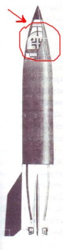

Hi, is it sattelite?
This is a clear fake.
The rocket depicted is (obviously) the A4 while the capsule depicted is part of an English post-war proposal called "Megaroc" (aimed to achieve manned suborbital flight), issued by BIS (British Interplanetary Society) chairman R. A. Smith.
All the details in the following link:
http://www.bis-space.com/what-we-do/projects/megaroc

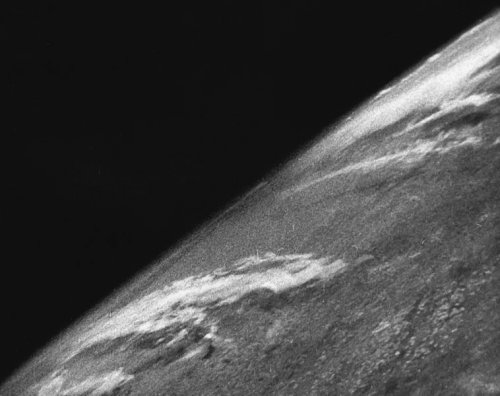

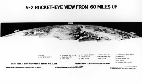

Hi, interesting fact: The first photo from space was taken from a V-2 launched by US scientists on 24 October 1946! So teorettically V-2 (modified) can reach space and bring sattelite on orbit

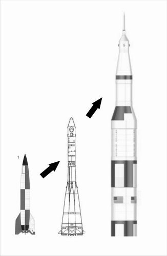

Vladimir said:
...So teorettically V-2 (modified) can reach space and bring sattelite on orbit
Of course, see attached timeline for development
(source pictures from http://www.luftarchiv.de/flugkorper/v2_camo_1.gif, http://eandt.theiet.org/magazine/2011/03/images/640_rockets.jpg, https://upload.wikimedia.org/wikipedia/commons/d/d5/Saturn-V_Shuttle_Ares-I_Ares-V_comparison_%2806-2006%29.jpg)
As you ( I'm tempted to say, as usual) didn't mention the source, it's hard to judge the height this photo was taken.
Judging the visible curvature of the earth it was relatively low. The greatest height reached by a V2/A4 during tests
in the USA was 234 km (see https://de.wikipedia.org/wiki/Liste_der_Versuchsstarts_der_A4-Rakete#Start_von_A4-Raketen.2C_welche_von_den_USA_als_Kriegsbeute_erbeutet_wurden,
about the height of the lowest possible orbit, I think.
But ... there's quite a difference between just reaching a height and delivering a payload to a stationary orbit, I think.
The latter needs a speed of at least 7,9 km/s, AFAIK the ("unmodified") V2/A4 was just capable of about 1,6 km/s.
To increase the max speed of a rocket by a factor of about 5 certainly needs quite a lot of development.
It's no matter of heigh rather than a matter of terminal velocity (in terms of Delta-V and mass-ratio).
The A4 couldn't simply get to orbit no matter how high it could go, the same happens today for ESA's Sounding Rockets take the MAXUS for instance it could reach 800 km of apogee (the double of the ISS operational altitude) and still it couldn't get into orbit since its terminal velocity is far (really far) the 9 km/sec needed to achieve a stable LEO.

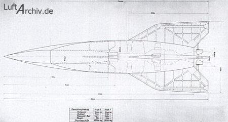

Agree, but i told that it must be modified rocket, plus A-10 booster would be used is they try to launch sattelite
May 10, 1946: A captured German V-2 rocket achieves high-altitude space flight at White Sands Proving Ground, reaching an altitude of 70 miles- its 112,654 km-max altitude, add here the calculated alltitude of the A-10! And the speeds: the final design of the A10 booster was powered by a 1,670 kN (380,000 lbf) thrust rocket burning diesel oil and nitric acid, during its 50-second burn it would have propelled its A9 second stage to a speed of about 4,300 km/h (2,700 mph)
NO.
Even with the A-10, the system was not even close to orbital. The LOX/alcohol propellant was pretty awful and the mass ratios atrocious. In order to lurch even a small payload into orbit, the A-9/10 would need the A-11 stage underneath *that,* and the Germans were *nowhere* near capable of building the A-11.
In order to get a payload to orbit, the Redstone rocket needed to be *greatly* improved over the V-2. Stretched, improved engine, improved mass ratio, and greatly improved control systems. It's not simply a matter of nailing a satellite to the top of the missile and wishing real hard.
And orbital speed is about 19,000 miles per hour. That's 7 times faster than the A-9/10. And in terms of *energy,* that's 7*7 = 49 times short of orbit. The A-10 was *nowhere* near orbital in capability.
