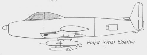

It wasn't before I browsed through "Les Avions Breguet" today, that I noticed a
drawing of an early design of the Br.960, which later led to the Alizé.
On this drawing a missile is carried, which, I'm sure is a Henschel Hs 293 . Did the french
actually used these WWII german guided bombs ?

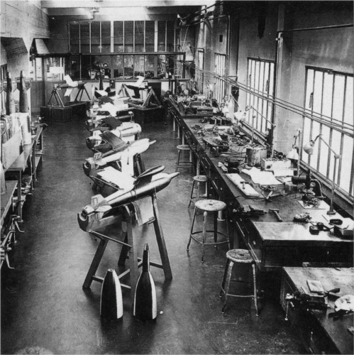

The French copy of the German X-4 was not the AA-20 but the AA-10. Several AA-10 were launched in December 1946 with poor performance.
The French Navy tested first the Ruhrstahl X-1 (renamed Pluvier) then the Henschel Hs 293 (renamed Palombe) from Hyeres and Saint Raphael in the South-East of France. Tests continued until 1947 with 74 Palombe manufactured in France.
