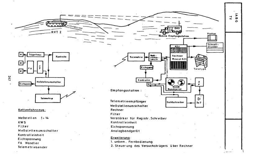

Here's how RVT-2 actually works:

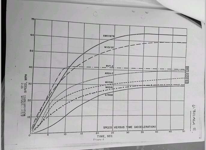

and here's how RVT-2 drives:
0 to 40 mph(64.4km/h) in 10 seconds! Maximum speed 43 mph(69km/h)
