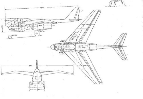

Hi guys,
Manfred Griehl states in "Jet Planes of the Third Reich: The Secret Projects", volume Two, page 224, that the Heinkel P.1078A was to use an early form of lock-on fire control, shown below with a dish antenna. In volume one, page 104, he writes that this "advanced automatic triggering of the weapons was designed by Heinkel engineers early in 1945".
Does anyone knows about this?
Hi Justo,
I have my doubts. The dish is small for a range of 10 kms as in the Pauke SD/Bremerhaven, despite operating in the 3cm band. Mr. Griehl rules out its use as a night fighter. It could operate as the radar gunsight of the F-86, linked to the gyro gunsight ( EF42/45 ).
Gosh sounds an awful lot like the F-86F sabre with it's primative radar gunsight. Nothing new under the sun aye?
