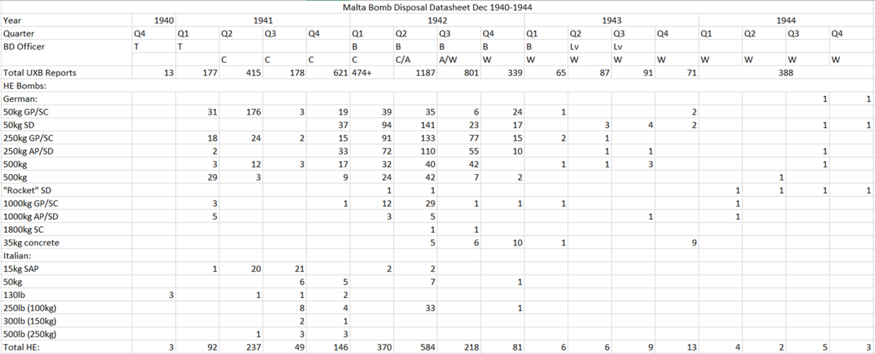

Here is the total number of bombs dropped on Malta including Italian types, which I left in as a comparison, as I find the raw data quite interesting. I will also do some graphs, and I will also open a general thread for Bomb disposal in Malta between 1940 and 1944 for some further context. [1]
I would like to make note that these numbers are only representative of the lower end of the spectrum, as the bombing was so heavy in the first half of 1942 that record keeping was limited as the officers in charge were constantly overstretched. The total number of UXB reports does not also refer to single bombs, in many cases they were reports for multiple bombs, especially after anti-personnel bombs became more common.
High Explosive bombs:

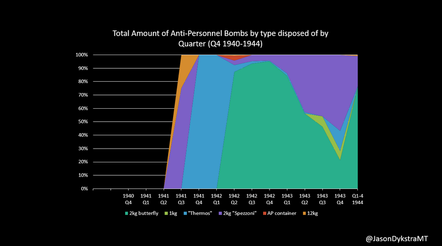

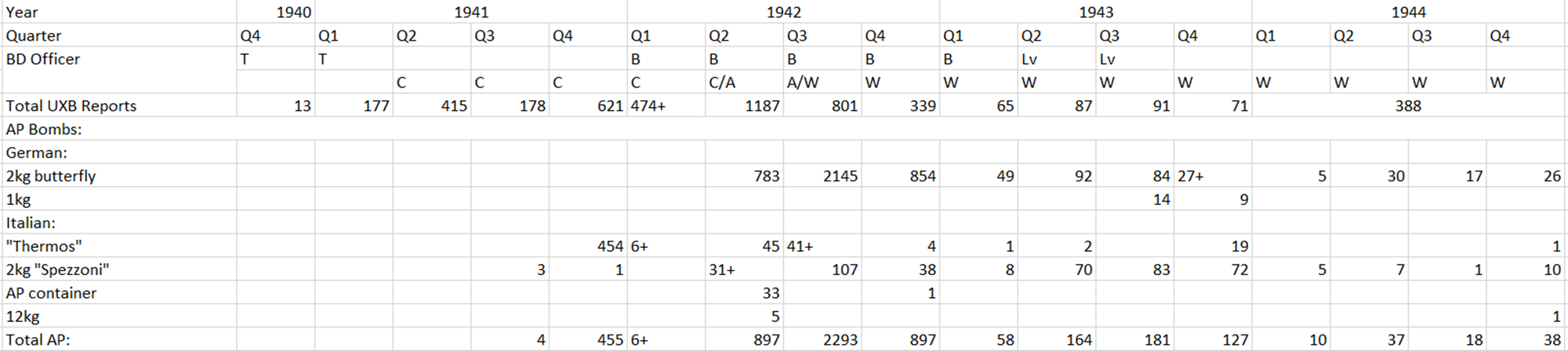

Anti-Personnel Bombs:

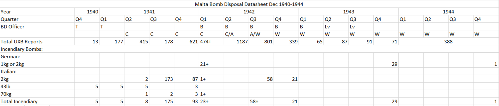

Incendiary Bombs:

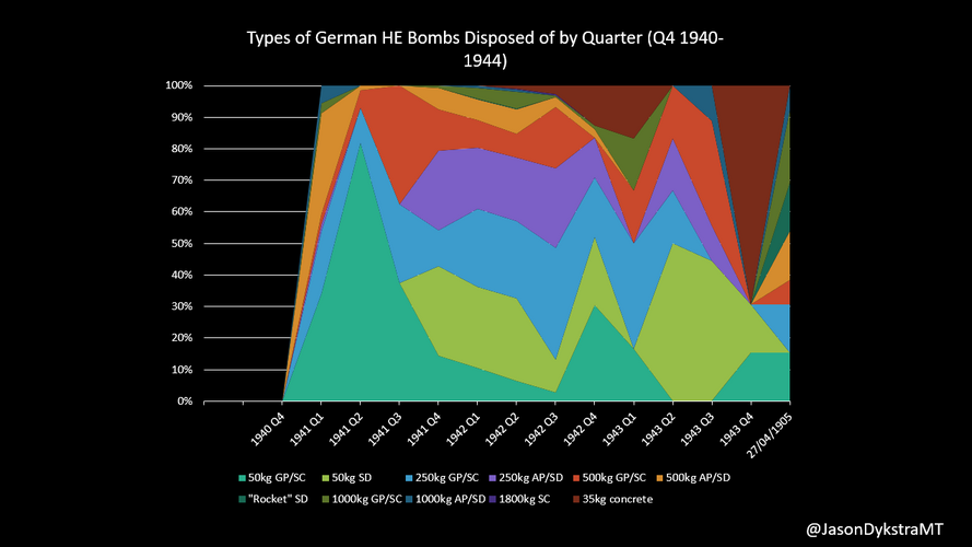

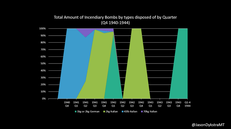

I have edited this thread to include some raw numbers, as well as the graphed out data.
