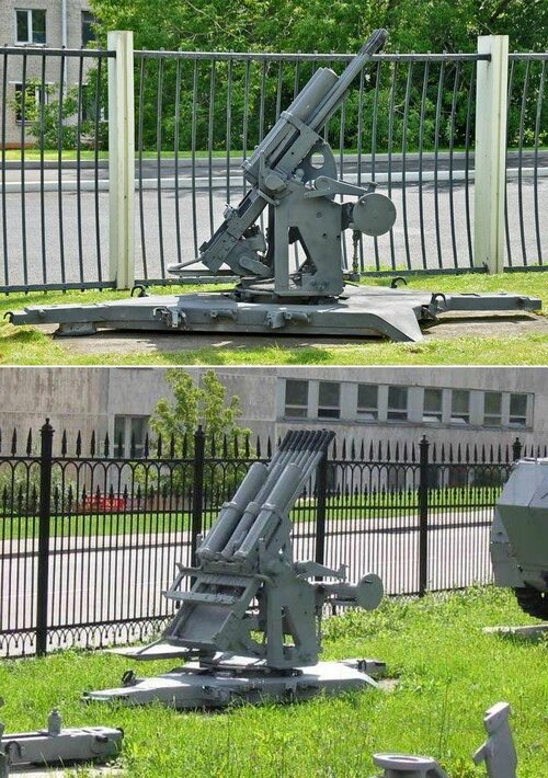

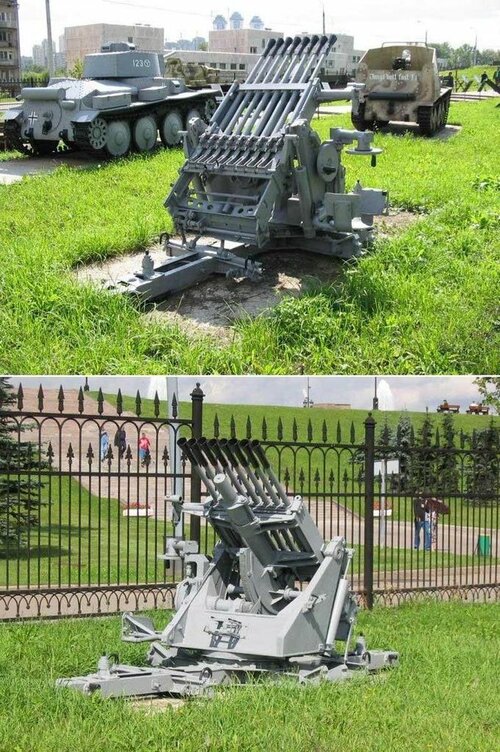

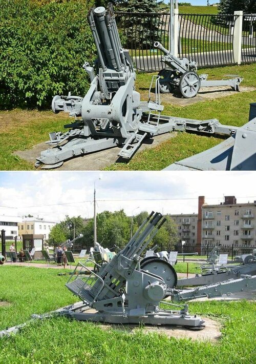

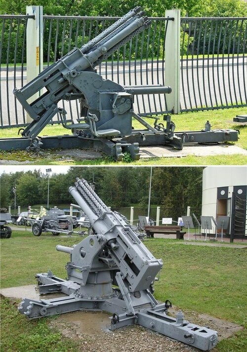

Developed by Rheinmetall-borsig in the 1930s, the prototype anti-aircraft weapons salvenmaschinenkanonen 2-cm SMK 18, were never adopted for technical reasons. Other flaks were perfected and produced but these prototypes stored somewhere in Germany fell into oblivion and then came the end of the war and the rush of the allies to seize German weapons of all types. Years later, these prototypes reappeared, on the Russian side, a long-lost and forgotten find of the spoils of war seized after the war: the four prototype anti-aircraft weapons of Rheinmetall-Borsig, are exhibited in the park of a museum in Moscow. SMK 18.jpg ( Waffen Revue 036-106-107-108-109-112-114 ) ( nuts-and-bolts-vol-03-pt1) (nuts-and-bolts-vol-08-pt2 ) ( https://henk.fox3000.com/nuts-n-bolts.htm )

Four or five such weapons were designed in the early 1930s for the OKH, 16 mm ML 16 by Mauser, 16 mm Mehrlaufwaffe by Gustloff and 2 cm SMK 18 V1 and 2 cm SMK V2 by Rheinmetall, plus eventually a certain ML 17. It seems, the one described as the "Waffe 1" in the photo above is the 2 cm SMK 18 V1.

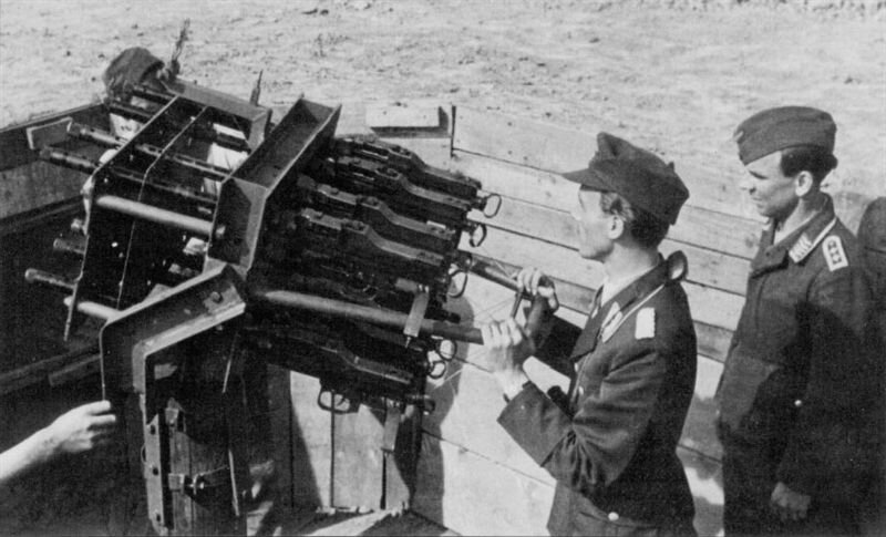

There were also some MG81 Salvenmaschinenkanonen. THey were cumstom build by Luftwaffe units.

It's not exactly the same concept - these made with MG 81s were just 8 machine guns mounted on a single cradle. The SMK, however, was a single gun firing simultaneously with 8 barrels fed by a single breech block. It seems, inconsistencies in discharges by individual barrels caused vibrations and stoppages, which eventually led to abandonment of the idea.
