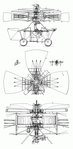

Stargazer2006's image came from US1561424A. Click on the link below and then on the image thumbnails.
-- https://patents.google.com/patent/US1561424
