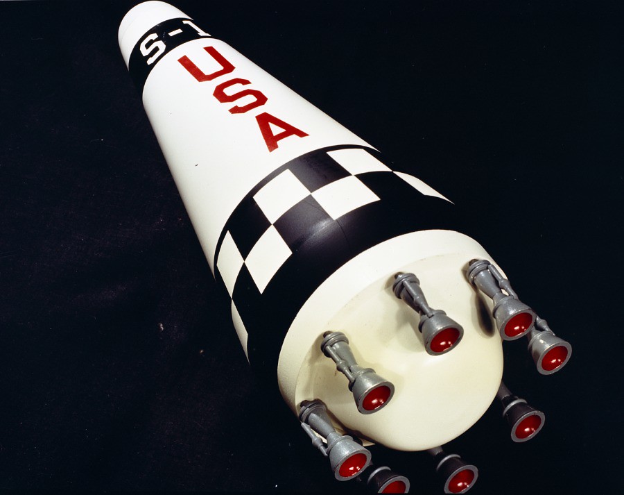

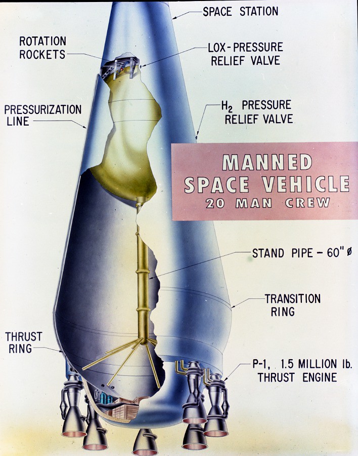

General Dynamics propose this project around 1961
A SSTO carry a Space Station with 20 men crew in low orbit

Interesting. Being a circa 1960 proposal, especially for an SSTO, some optimism is apparent.
Making the assumption that the 'P-1' engine is equivalent to an M-1, performance could be anywhere from zero to 250 tonnes in LEO, depending on losses and the tank fraction. Being as it's a General Dynamics design, I'd assume Atlas/Centaur heritage and a pretty good tank fraction, but a heck of a lot of risk too.
We see the same plumbing off the stand-pipe and H2 tank in Musk's BFR. Great minds think alike. I do note, with the S-1, that they played it conservatively with the O2 tank -- not going with the common bulkhead of Centaur.
1.5 ton thrust each motor. That would be F-1 class stuff, wouldn't it? And with the base of the nozzles so low, would the truncated spike serve any useful altitude thrust correcting work?
And that flame-pit. Would not the Chinese protest?

merriman said:
1. We see the same plumbing off the stand-pipe and H2 tank in Musk's BFR. Great minds think alike.
2. I do note, with the S-1, that they played it conservatively with the O2 tank -- not going with the common bulkhead of Centaur.
1. Nothing new and not indicative of a "great mind". Just another way to skin a cat.
2. Quite the opposite, it is a common bulkhead
And fools seldom differ. Only so many ways to arrange the plumbing after all.
F-1 class thrust but with LOx/LH2 - which makes it more nearly an M-1, initially 1.2 Mlb thrust but with growth to 1.5 Mlb thrust expected.
Doubtful; I suspect it would turn out to cause bad problems with base drag and need a major redesign. That was where the centre engines on the Saturn V and N1 originally came from, if I recall correctly.

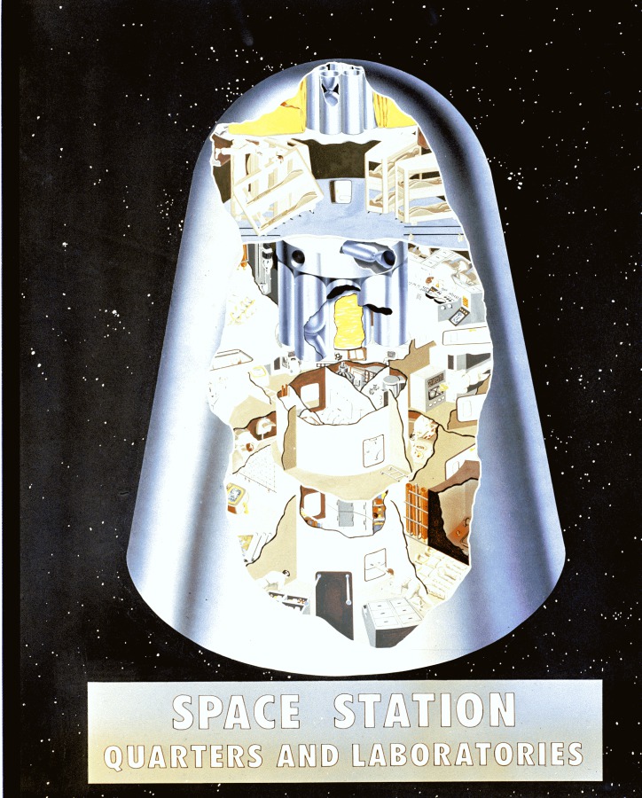

finally the Picture about space station itself
