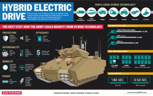

Apophenia said:
That connection may answer the speculation about engine placement. The FCS MGV placed its MTU 5R 890 diesel above the portside tracks. Perhaps the GCV IFV's engine placement would be similar?
Its not speculation its how it is. As I mentioned in my post before the one you quoted:
Abraham Gubler said:
The generators are in the sponsons behind the turret above the tracks. There are two of them one on each side but the left side one is the primary unit. This is the same design as the FCS MGV just with a stretched hull to accommodate a hull penetration turret.

Regarding a hybrid powerplant, I wonder if this joint US-Japan project will bear any fruit: http://www.dtic.mil/dtic/tr/fulltext/u2/a577548.pdf
