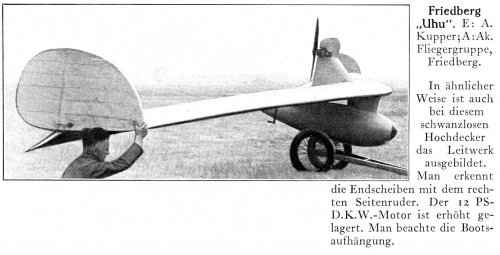

I do not know if this Uhu (Owl) was meant as an early target aircraft or a small-scale demonstrator for an larger design but I couldn't find any trace of this original high-wing tailless pusher elsewhere on the forum, so until we have more information and a better place for it, I'm starting this topic. Does anyone know more about it? (source: Jahrbuch der Luftfahrt 1931-32)

The description says, that it was built by the "akademische Fliegergruppe Friedberg" (academic
flying club Friedberg). Don't know, if in 1930 there already was a university in Friedberg, but maybe
it was a branch of the university in Gießen then. But as it quite probably was built by students,
I think it was just a small light aircraft to test the tailless design, but not necessarily with the
aim to use it in another way.

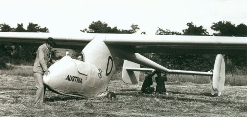

...Kupper Ku.4 "Austria"...
I´ll be very happy to see pics and/or drawings from the Ku.7. Infos about Ku.5 and Ku.6 are welcome.
Thanks richard, a problem closed. I know this sailplane only as Kronfeld Kr.1.
