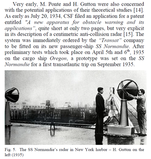

France was developing radar sets since at least 1934, marked with CSF's installment of a radar set on SS Normandie the year after. But it didn't stop there. Intriguingly, the French also managed to continue developing radar in the German-collaborating Vichy France. There are a ton of historical material on this paper:
