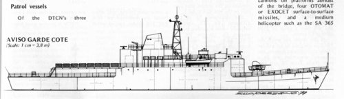

I'll post an Aviso Garde Cote project profile tonight and some data refered to C1800 and AR1200.

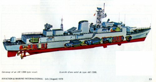

AR 1200 Escort data
The hull is practically the same as used in the A 69 class
Displacement: 1230 tons at average load
Dimensions (m) : 86 x 9,9 x 2,88
Armament: 100 mm/55 cal gun, 2 x 20 mm cannons, 2 x quadruple launch containers for MM40 Exocet, eight-cell launcher for Crotale Naval, a 40 mm gun and 2 x twin ASW torpedo tubes.
Electronics fit is the same as for the C 1800 project, except that there is no provision for a VDS.
Propulsion is by four SEMT-Pielstick 12PA6 BTC diesels with a maximum continuous rating of 6000 hp, which drive two shafts.
Other variations on the A69 theme are the AR 73, the Type 11 and the Type 4B which differ from the original almost exclusively in their weapon fits. The AR-1200 is the project that differs most from the original.

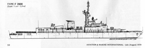

F2800 data
Displacement: 2800 ton
Dimensions(m): 116 x 12.8 x 3.8
All-diesel machinery: 4 x SEMT-Pielstick engines developing 7200 hp
Max speed: 30 knots
Range: 7000 nm at 18 knots and 10,500 nm at 15 knots
Armament: 100 mm/55 cal gun, Creusot Loire 375 mm six barrel ASW rocket launcher, 2 x Breda twin 40 mm/70 cal guns, 2 x 6 launch contairners for MM40 Exocet, 1 x Crotale Naval,

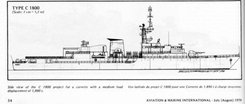

C1800 Data
Displacement: 1800 ton
Dimensions(m): 102 x 11.8
All-diesel machinery: SEMT-Pielstick engines developing 6400 hp
Max speed: 31 knots
Range: 4000 nm at 18 knots and 5500 nm at 15 knots
Armament: 100 mm/55 cal gun, 2 x 6 launch contairners for MM40 Exocet, 1 x 8 cell Crotale Naval, 2 x Breda twin 40 mm/70 cal guns and 4 to 8 ASW torpedo tubes.

F2800 data
Max speed: 30 knots
I found a site based on the size this ship was most likely the one the navy wanted http://www.armsdeal-vpo.co.za/articles16/alternative.html

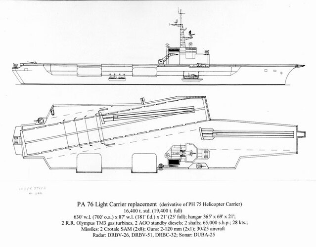

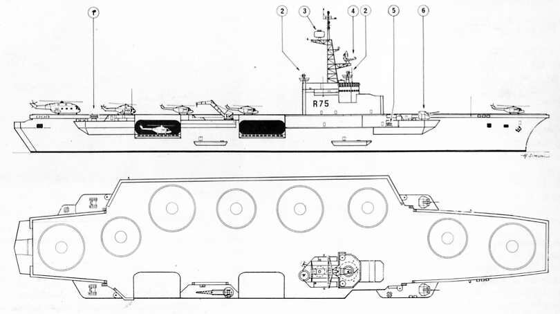

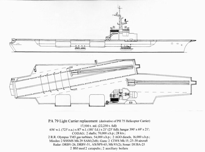

Just for the record, the decision to build a new carrier was taken by President Giscard on September 23, 1980; but CdG as such (called Richelieu for a time) started in February 1986.
Why the six years, I never figured; probably to refine the design from PH75 to CdG, trippling the tonnage (or nearly) in passing.
