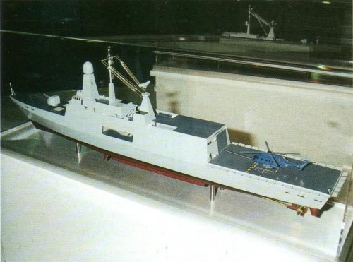

From Matt at the archived Shipbucket forums:
First in the French variant of the NATO NFR-90.
Specs given at the time were :
Displacement (full load) : 5,000 mt
Length : 131 meters
Speed : 25 knots
Range : 5,000 NM @ 19 knots
Crew : 201
Weapons : 1 x 100mm Compact gun, 48 VLS cells for Aster 15 (32 forward, 16 aft), 8 MM-40 Exocet, 2 Mistral launchers, 1 medium helo (NH-90 or EH-101)

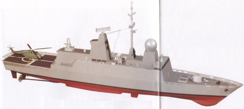

The Model shown below is EOLES (Escorteur Oceanique Leger a Effet de Surface), an SES corvette for blue water ASW.
Specs given in 1986 were :
Displacement : 950 mt
Propulsion : CODLAG - 2 x 5,000 SHP diesel engines for off-cushion cruise, 2 x 1,000 SHP electric motors for quiet mode, 2 x LM 2500 gas turbines for high speed.
Speed : 18 knots off cushion, 50 knots on cushion
Weapons : 2 x twin torpedo launchers for 324mm torpedoes, 4 x MM-40 Exocet, 2 x Mistral SADRAL launchers, 2 x Super Puma helicopters
Crew : 90
http://z11.invisionfree.com/shipbucket/index.php?showtopic=1420

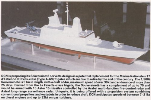

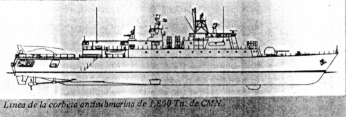

From Le Bourget Naval 1984 in Spanish magazine "Defensa".
Not described in the main text, just a table with technical data:
Lenght: 91 m
Beam: 12,2 m
Draft: 3,7 m
Displacement: 1,802 Tn (max)
Speed: 30,5 knots (max)
Range: 5,800 miles at 15 knots
Powerplant: 4 diessel engines 9,500 hp each
Crew: 120
Weapons: 1x76 mm gun; 1x30 mm Goalkeeper system, 1x8 cell Crotale Naval SAM, 2x4 cell Exocet MM-40, 2x3 tube torpedo launcher (Mk 32, Mk44 or Mk46), 1x SA-365 Dauphin multi-role helicopter.
