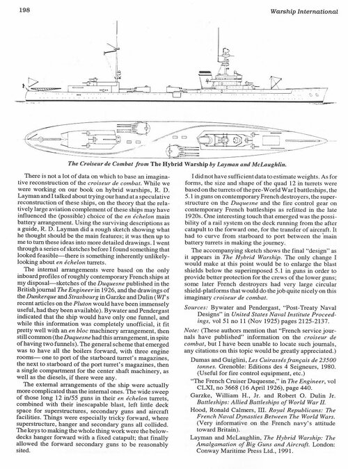

my friend give me two pictures about french grand cruisers in 1920s&1930s .He said that these designs older than Dunkerque.(ノ ○ Д ○)ノ
Any body know where these drawings comes from? A book or article?(゜ロ゜)
Why French stop these grand cruisers
design?⊙ω⊙
e44659d3cf715d0a0fcaf94f1d00bc92f57df757_raw.png d759fdb3ece05df2bfc19b51e62a2961da0face0_raw.png
Yes it was from French Battleships by Jordan and Dumas
Excellent book with many unbuilt projects and variants.

That I've heard a non-official proposal or likely a wrongly represented proposal (Like the early No.13 drawings of the IJN ) of the data than avaiable.
Such Admital deFeo style arrangement (All main turrets on the center of the ship between the superstructures) were not studied by the MN only after 1930 with the emerge of the Richelieu class
