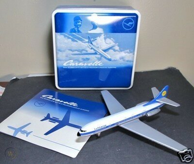

The German national carrier Lufthansa did not buy the ordinary Caravelle. Nor did it buy the small VFW614 feederliner.
Lufthansa were sceptical about the economics of supersonic flight but did hold options both for Concorde and the US SST.
A German design for an SST is illustrated somewhere online. I will try and find it.
