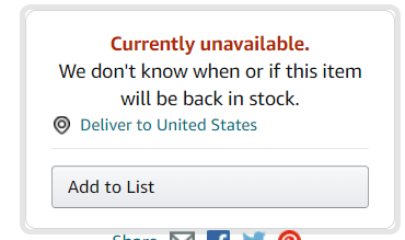

Ewen, is this book available in the UK?? I can't find it here at amazon, Barnes and Noble or Abebooks.
Thanks.
AlanG
Ewen, Thanks for the head's up on the 100 Group. I've ordered it.
AlanG
Thanks.
AlanG
This is the first one I recommended. Histories of all RAF and Commonwealth Liberators. But long out of print. I’d forgotten just how long I’d had it!

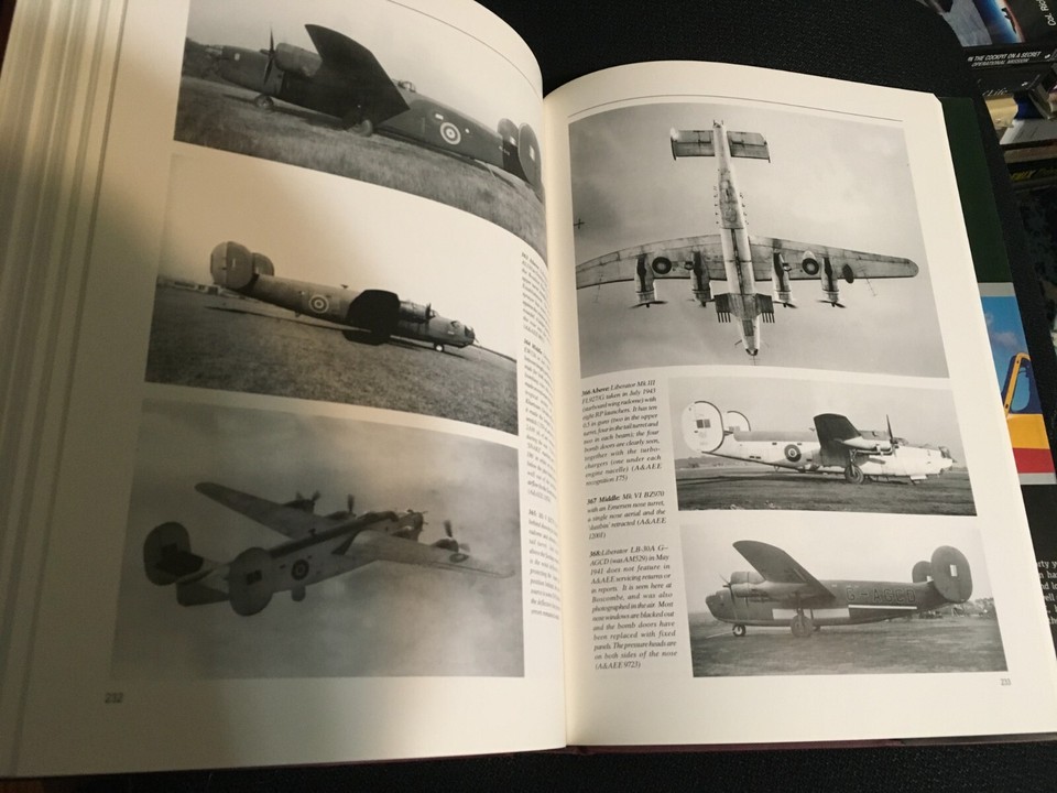

Coming in very late, but there's a photo of BZ970 in Tim Mason's The Secret years' book (Scan from ebay below)
BZ970 is shown on the middle right hand side. It's a H-1-CF
