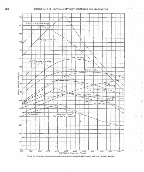

Helpful?
It's quite interesting, but it's also a bit of an odd collection of not so well referenced data points. The Spitfire data for example is somewhat puzzling, as in tests with installed vs. removed wing tips on the same airframes, the conclusion was that clipped wings provided:
"(i) A small increase in the rate of roll of aircraft with originally poor ailerons, but little effect on aircraft with good ailerons.
(ii) A slight increase in speed at heights below about 20,000 ft."
As they came with a number of disadvantages, mostly concerned with turn and high-altitude performance, the recommendation was not to remove the wing tips from Spitfire aircraft, which went against the original suggestion of removing the wing tips from all Spitfire XII aircraft, specifically.
Regards,
Henning (HoHun)
