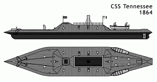

Great work ! I just wouldn't follow with regards to "stealth", although it surely is in the "good
tradition" of National Geographics and their "sensational" Horten story.
But although the good old CSS Tenessee (drawing via http://www.cityofart.net/bship/tennessee.html)
looks externally quite similar to the USS Sea Shadow, I wouldn't call the former a "stealth ship" !

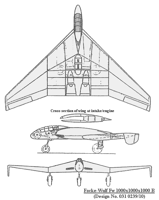

Is this the same design as this one?
"Cuz the nosewheel's going to be problematic on your model.
Yes but a little "germanised".....with a real airfoil for a fliying model... a credible air intake......and a true "low radar signature" body shape
i think that the original blue print is very "americanised" and designed after the ww2 may be in 50's..???

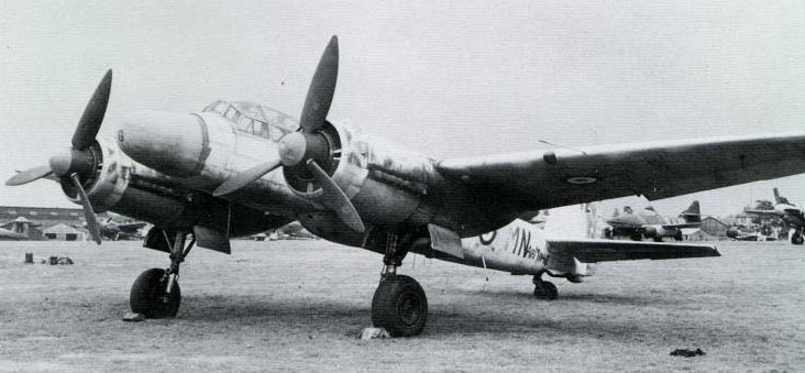

Looks great. One minor nitpick though: surely something as advanced as this would utilise something akin to the FuG 240 "Berlin" radar by the time it entered service and thus have a enclosed radar such as on this Ju88G:

And "typical German" for the late war jet designs was, I think, a radome covering a dish antenna, as shown by GTX.

GTX Using a "Fug berlin" in the noze is not realist....it's create an obstacle to pilote viewpoint.....
Absolutely right, I think, but maybe that's just showing soem shortcomings in that concept ?

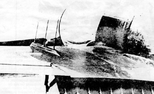

Another thing to consider perhaps is, that the FuG 220 was a development from around 1943.
If ..the Fw 1000x1000x1000 would have been servicable in, say1947 ?
Four yerars in the field of radar development wasn't just much time then, it were aeons !

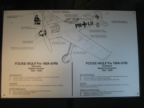

But if you want to cling to that type (maybe because the advance of the Red Army had led to the biggest
part of the German radar scientists and engineers being captured and brought to Siberia by the Russians,
so that all could be done was making due with outdated electronic equipment ;) ), perhaps you should consider
moving the antennas to the wing leading edges, as was done with the FuG 216 antennas in the Fw 190 ?
(photo via http://www.oncamouflagedwings.org/saw/sanmmh14.jpg )

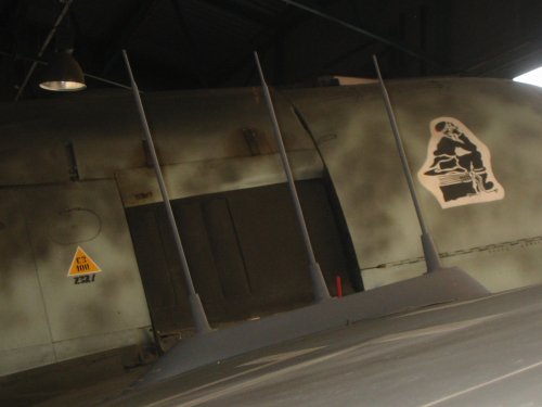

Details of this installation on the FW190 on show at Johannesburg War Museum:

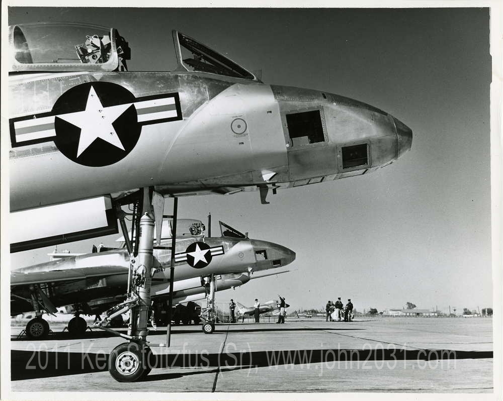

I acknowledge the potential for the dish array/ radome interfering with pilot vision though one could potentially alleviate this by offsetting the radome etc slightly lower (with probably a teardrop fairing underneath to 'blend' back into the fuselage - maybe something akin to the nose on the F7U-3P in profile).
I certainly think the FuG 220 Lichtenstein SN-2 style 'Hirschgeweih' antennas as shown would be overly drag inducing and potentially even structurally unsound on a jet such as this. A more streamlined/advanced design using something akin to the 'Berlin' radar would be more likely.
I also tend to agree with Jemiba's comment re the single seater. A two seat arrangement would be far more likely for a dedicated nightfighter. The pilot would have their hands full flying and handling the early jets. To also ask them to handle the radar might be too much.

A lot of drawings on Luft'46 is based on real German's drawings. I have somewhere scanned copy of film with original Blohm-Voss drawings. But every redrawing it as a lot of "improvements"
Wow! I never realised it was this small. I always thought it was a two-seater with a capacious cockpit... Maybe two and a half times larger. I guess I should've looked at the dimensions...
It was somewhat larger than the 3d model (based on Orion's drawings), even if elements of the design were unfinished. But I still thought it was much larger.
