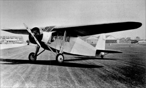

A strange design came after F-5,it was called F-20 ?,it was a Project.

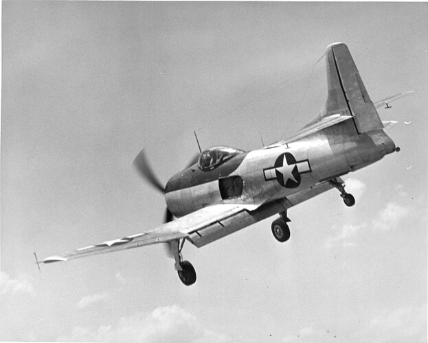

A XBTK-1 Pic:

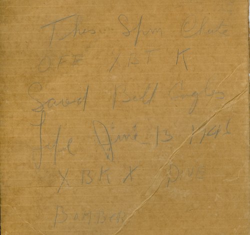

From Dad's Logbook 6A: April 2, 1945 Fleetwings XBTK-1 Navy 44313 P&W 2800 Taxi Run (first time XBTK-1 mentioned in his Logbook).

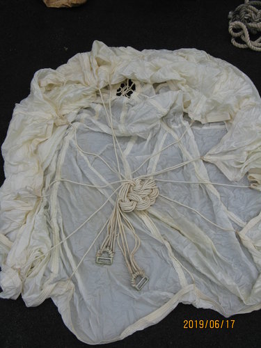

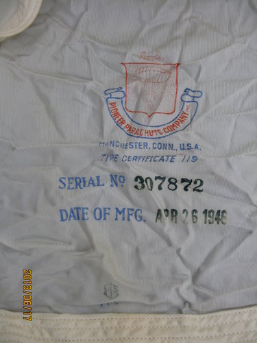

The XBTK-1 ended my Dad's testing career; his lungs were severely damaged during a dive test (as best I remember) on June 13, 1946. I still have the spin chute that saved his life:

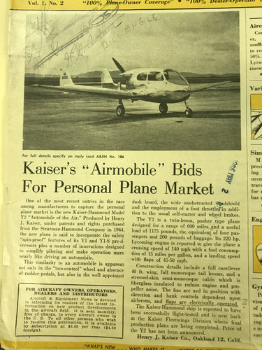

But I do have a question about the "Model 51 Kaiser-Craft" listed above (list above removed - edit 6/10/24). Was this an "older" (edit 6/10/24) version of the Kaiser-Hammond Model Y2? In the attached article, the engine in the Y2 was stated to be a 220HP Lycoming.
Y2 article:
From the April 1946 issue of Aircraft Equipment News:
Note in the article above, the "?" and underline, I imagine the flaps weren't electrically operated.

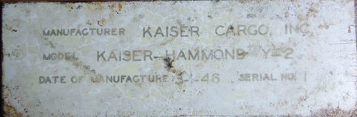

He did keep the nameplate from the Y2 which I have in my possession:
