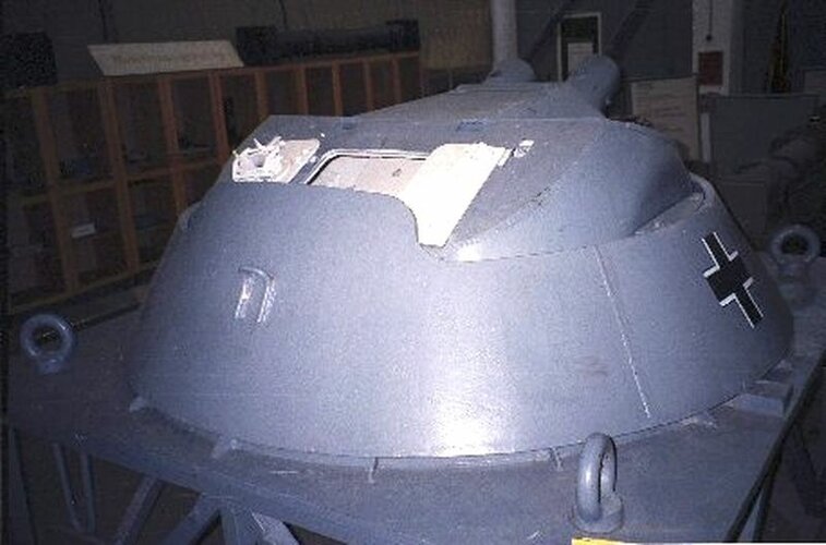

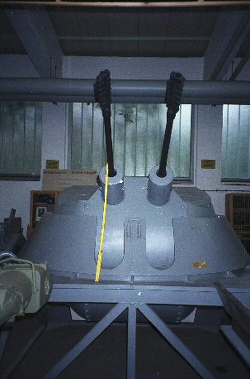

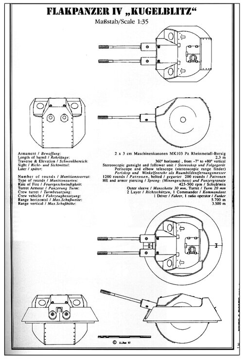

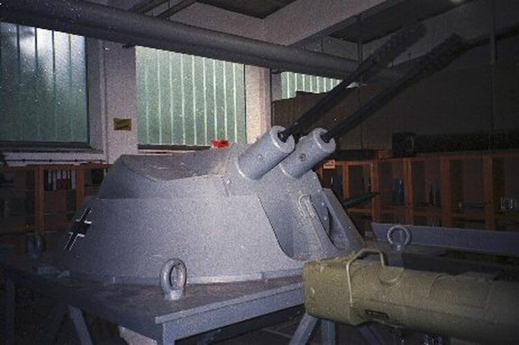

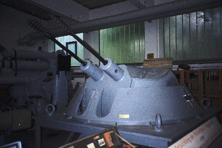

The new turret, which somewhat resembled an oversized aircraft ball turret, mounted twin 3 cm M103 belt-fed aircraft autocannons.
The new turret required a larger turret ring, and accordingly a Tiger I turret ring was incorporated in the chassis, which required relocating the driver's and radio operator's hatches
