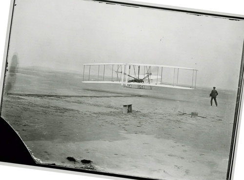

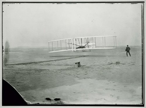

Is it an impression or the iconic photo of the "first flight" presented on the NASM website has been "photoshoped" to show an horizontal background (but a tilted personnage)?

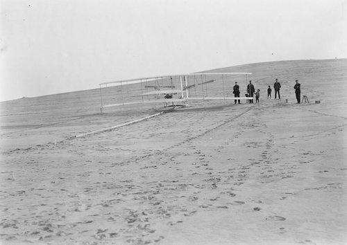

They were not called Kill Devil Hills for nothing, as the 14 December image shows. But I believe that contemporary documents support Crouch's assertion that the historic flight took place on the sand flats beneath. Many impartial historians have covered these events in microscopic detail - I have a couple of tomes on my shelf which devote some space to it - and I have never found cause to doubt these claims. One must remember too that they were strong enough for intense legal pressure to cow the Smithsonian Institute itself - it did not give in lightly.
