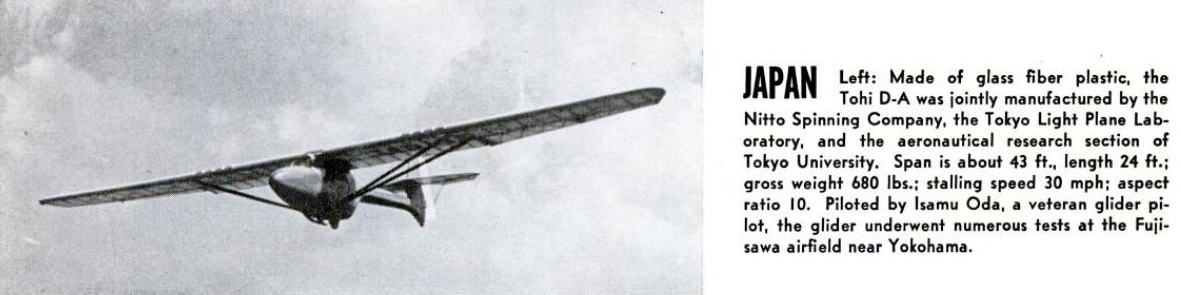

The glider in question, which was fitted with a wooden wing, was also known as the LBS III, or Tohi SB. It, or more likely an immediate predecessor, seemingly flew for the first time on 31 May 1956.
