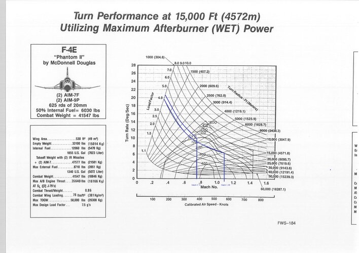

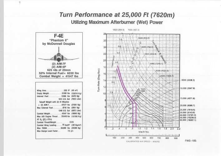

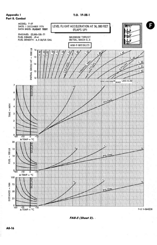

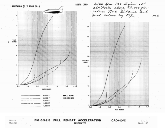

The electric lightning F-6 still accelerate much faster than the F-5E
By contrast, F-5E turn better than the lightning F-6

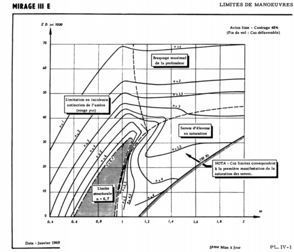

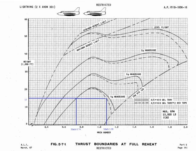

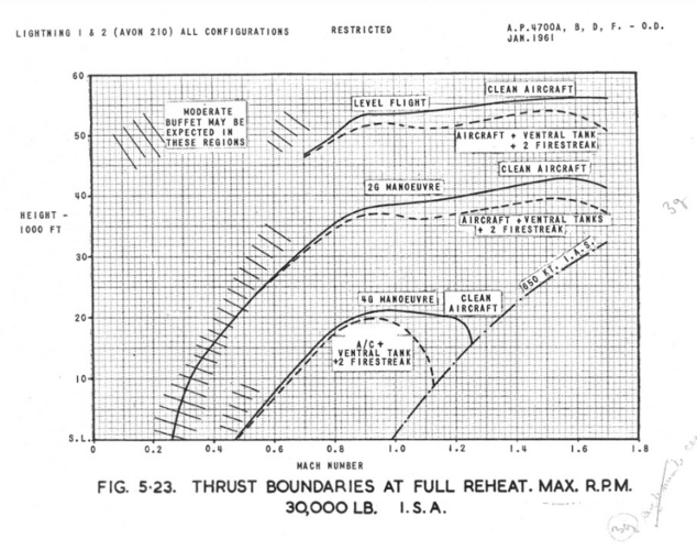

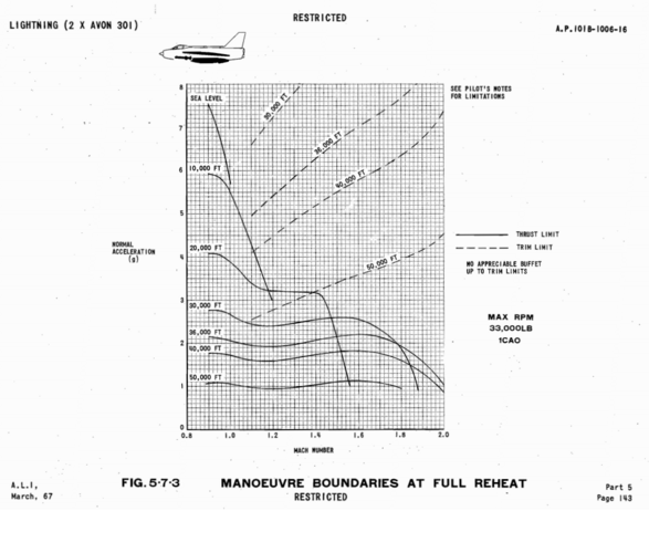

I finally found some chart to compare the maneuvering limit of Mirage III and English electric lightning F6
Unfortunatley, I can't find any chart of the EEF mark 6 without the ventral tank, only the mark 1

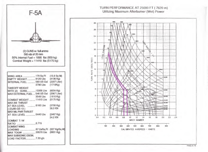

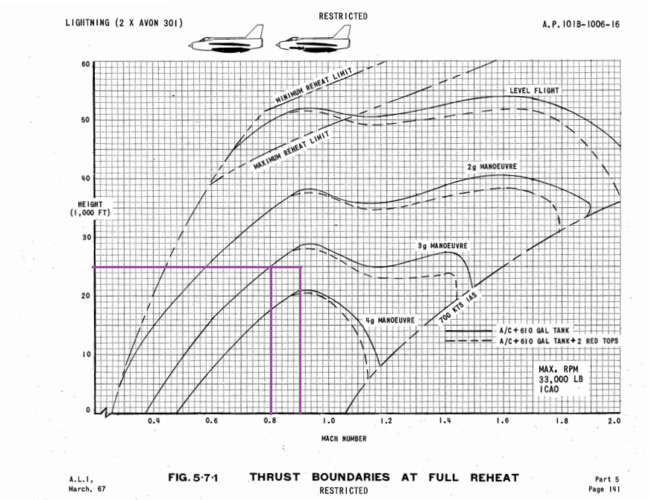

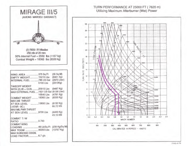

I finally found proper charts to compare the three aircraft. Turn out, Mirage III is the one with the worse turning capability at subsonic regime
In term of sustained turn rate:
Altitude: 25000 feet, Speed: Mach 0.8
Mirage III
can sustain 3G
F-5A can sustain 3.5G (F-5E can do even better)
English Electric Lightning F-6 can sustain 3G
Altitude: 25000 feet, Speed: Mach 0.9
Mirage III
can sustain 3.5G
F-5A can sustain 3.9G (F-5E can do even better)
English Electric Lightning F-6 can sustain 3.5G

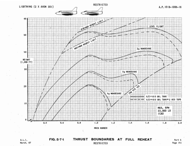

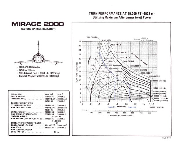

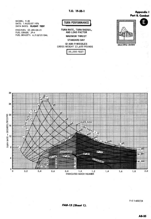

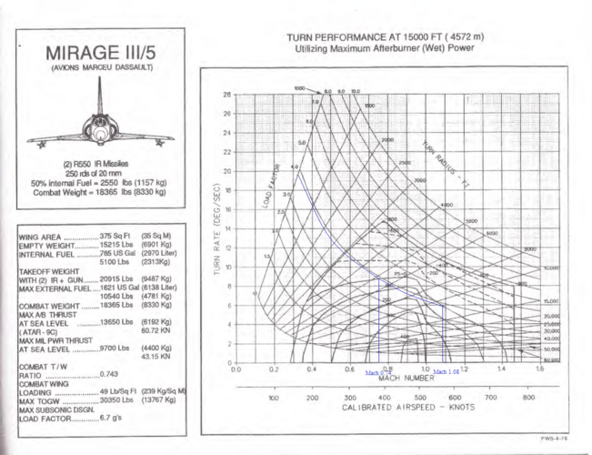

At 15000 feet, Mach 0.74
Mirage III
can sustain 3.9 G
F-5E can sustain 4.2 G
English Electric Lightning F6 can sustain 4 G
At 15000 feet, Mach 1.08
Mirage III
can sustain 3.9 G
F-5E can sustain 2.5 G
English Electric Lightning F-6 can sustain 4 G
Yeah sure, the delta was a giant airbrake. Without FBW, it was hopeless. Then again, it doesn't seem to have bothered ISraeli pilots against (nimble) MiGs, including at low level, low speeds.
What suprise me the most is how good can the English Electric Lightning F6 turn, it suprisinhly nimble despite the extremely high swept wing and extremely high wing loading.

The Lightning's time to FL 360 in re-heat was 2.5 minutes, in this respect the Eagle produced a similar figure, though this could vary depending upon its configuration."
Hmmm......
Strange given the Streak Eagle got to 36k (12km) in 55 seconds. I wouldn't think an Eagle in service would be THAT much slower. (Yes, I know the Streak Eagle was stripped down.)
I decided to add some maneuver data of the famous F-4E in the comparison
F-4E
can sustain 4.4 G
Mirage III can sustain 3.9 G
F-4E
can sustain 4G
F-4E
can sustain 3.3G
Mirage III can sustain 3G
F-4E
can sustain 3.7G
Mirage III can sustain 3.5G
I disagree. It fundamentally changes the comparison.
The F-5E may not out accelerate or out climb a Lightening F.6 but it more than matches it’s armament (later all aspect AIM-9s out class the 15 year older UK equivalents, unsurprisingly) and is otherwise quite superior as a dogfighter.
If I recall correctly , F-5E also didn't have all aspect IR missile, while the Red top missile on Lightning F6 is an all aspect missile. So technically speaking I think Lightning F-6 still got superior weapon (of course not counting the much later F-5E with AIM-9L, Python, AIM-120)
Similarly the F-5E narrows any areas where a Mirage III may have an advantage and massive builds on areas of advantage versus a F-5A.
Its like pretending that the Mirage F1 or 2000 are the same aircraft as the Mirage III.
I don't have Mirage F-1 chart so I can't say for certain how good it is compared to Mirage III, but I can see the Mirage 2000 changed the comparison completely
For example:
At 15000 ft Mach 0.74
Mirage 2000
can sustain 5.3G
At 15000 ft Mach 1.08,
Mirage 2000 can sustain 5.1G
That mean if we replaced the Mirage III with Mirage 2000, it changed from being the aircraft with the worst sustain turn rate in the list, to the one with the best sustain turn rate in the list.
Furthermore, Mirage III structure G limit is at 6.3G, F-5E structure G limit is 7.33G, Lightning F6 structure limit is 8G. In other words, at low altitude, where the air is thick, Mirage III is also the one with the worst instantaneous turn rate. By contrast, Mirage 2000 structure G limit is at 9G and it can turn even better than F-5E
At 15k ft, the maximum instantaneous turn rate of
F-5E is 17.8 degrees/second
F-4E is 14.1 degrees/second
Mirage III is 15 degrees/second
Mirage 2000 is 23.8 degrees/second
At 15k ft, the maximum sustain turn rate of
F-5E is 9.9 degrees/second
F-4E is 10.1 degrees/second
Mirage III is 9 degrees/second
Mirage 2000 is 12.5 degrees/second
